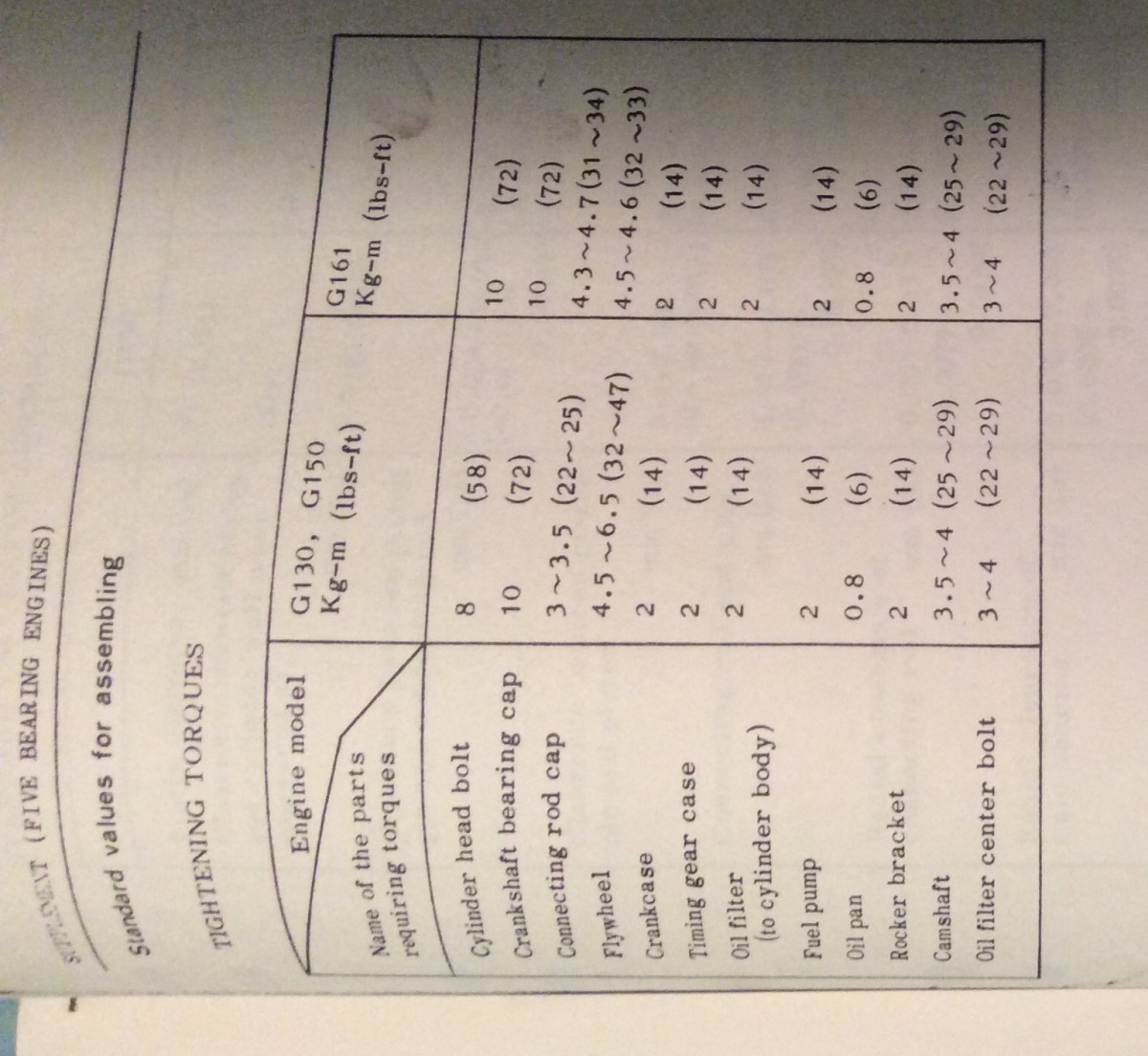

Here is the table of tightening torques for 5 bearing engines,
Lewis.
Sun Jan 08, 2017 7:56 pm
Yippee.
Thank you so much
:D
Sun Jan 08, 2017 8:53 pm
Lewis beet me to it.
That is the same book I have.
Mon Jan 09, 2017 4:27 am
Tis good 67GT :D
Wish it was easier to clean the head and block of the accumulated gunk.
40+ degrees then constant rain ... blah. Hard to get anything done at all.
Head is nice and clean now.
Next is to clean bolts and rocker gear, then if I can get some fine weather, the block.
Cheers everyone :D
