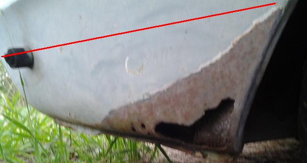

These are the low sections behind the rear wheels that often rust out in a Bellett.
AS indicated in another thread, I have approached a Restoration firm here to see if he will make replacement sections, both sides. [this guy is a genius in metal work. In his shop he had a 61 Maserati which he has almost finished re-making a whole new aluminium body for]
There seems to be some interest in this, and I talked to the guy yesterday and he is happy to quote for a number of them. If numbers are high enough, he will make up jigs which will help to keep the costs a bit lower.
I have to go back with my Sport next week so he can see what's involved, to give a quote. I need some reasonably firm intent to buy these, (subject to cost) so I can give him numbers to make and price.
At this point, I don't know how shipping will be arranged so that will be on top of the quoted price. And I think, rather than ask for left and right, will be done in pairs only.
The panel will most likely not come up to the crease line in the body as he told me the reverse curve involved would add a lot of extra cost. ie it will run up from the 'flange' at bottom to about the hole where the bumper bar bolts through. It would need to be MIG welded into the body, most likely. Another option is to have the top section of this replacement panel, swaged so it will fit under the edge of the joining panel to make welding a little easier..
So, please reply if you are seriously interested in these panels. (pair) Once I have numbers I will get the quote. Only then will you need to commit yourself. Please don't say yes if you don't want to pay more than '25c' for the panels......... you get the idea.

I spoke to another restoration place today at Melb Hotrod Show.
They don't do 'quantity' though. But i was impressed with the guy and his work. Maybe could drop off the spare Sport and get it back all restored !!!! :) :)
This guy mentioned that he knows somebody who makes custom low use press tools for making small items like these panels. However, final piece part price is likely to be fairly high.
Sun Jan 25, 2015 5:05 am
OK the news......
for 5 sets, the cost is $130.00 per side, CASH. Plus postage
LENGTH:
They will NOT extend right to the rear flange (they don't rust there normally and it would add huge cost as the panel gets complex there.)
They will stop approx where the bumper bolt hole is, lengthwise. At the front edge they will have the flange ready to spot or plug weld into the body.
Height:
will run up to about 70mm below the crease line in the body. He explained that any higher, would cause a lot of distortion when welding.
(unless they were to extend up the centre of the crease line but again would add a lot of cost.)
Any less than 5 sets, cost will go up even more.
This guy is pretty good. He has appeared on CH31 doing repair videos. But, I can't take any responsibility for what is produced. I am only the messenger. He will make a pattern from my car.
I am doing the running around and there is no payment to me at all. (ie I am not marking these up!) That is the price he is asking.
Those who expressed interest, please advise yes or no. I don't want to carry the can for those who say 'yes' then later say they don't want them, so think it over carefully before commiting.
If we don't have 5 positives, then the whole deal is off. And it's a once only 'offer'.
Payment will be upfront.
