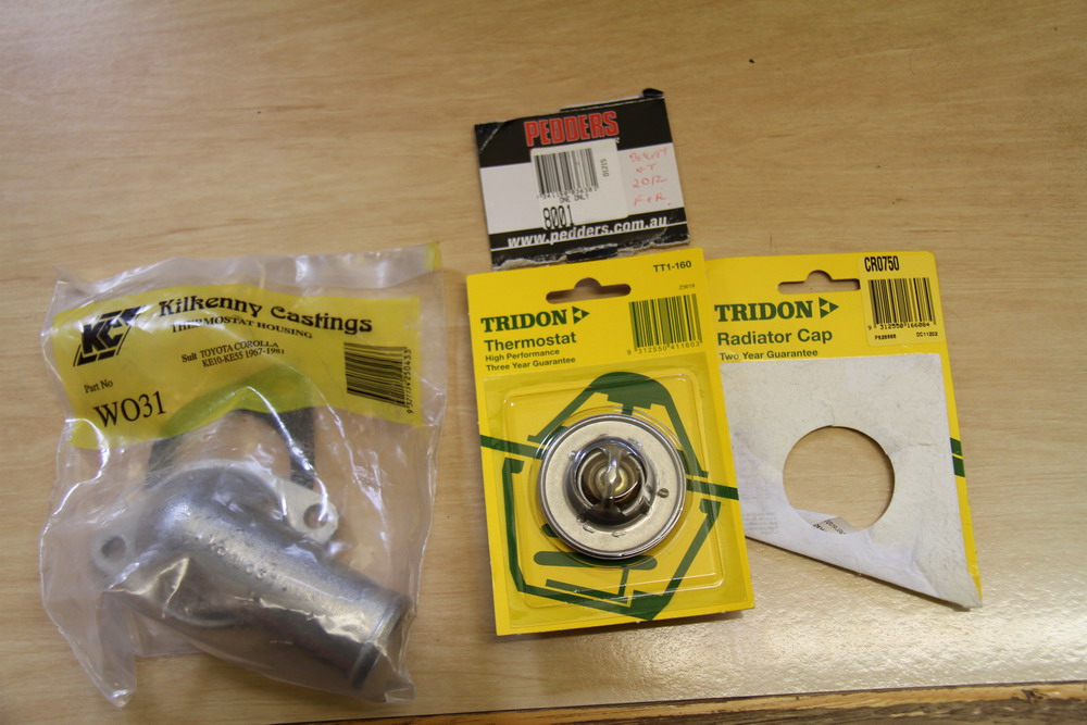

These fit a '67 GT.

hi Kerry and a 3 bearing 1600?? cheers davo
Sat Nov 22, 2014 1:21 pm
Possibly / Probably - do not know for certain Dave - not expensive .

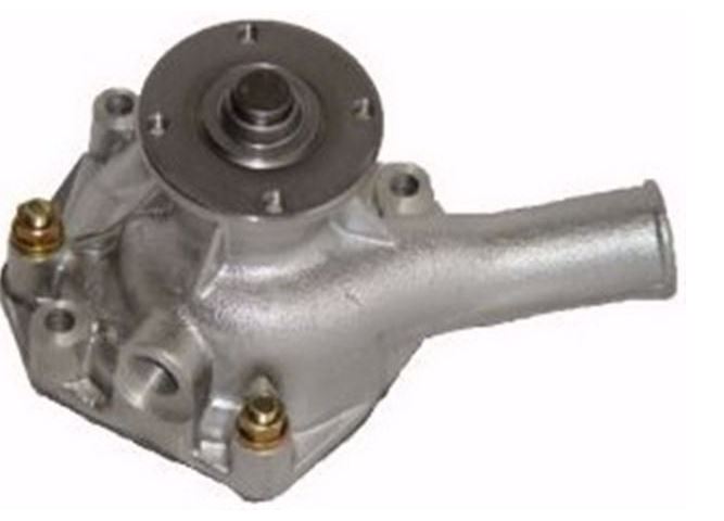

Hi All
Very Interesting
I rang the importer of Protex Water pumps in Victoria
They informed me that they have not sold 1 since 2009 and have a backorder of 50 or more but unable to say ETA
They couldn't tell me what motor they suit but sent me this photo as the actual pump
Perhaps you are onto something
Please keep us informed
J

That's interesting. One wonders where the back order of 50 might have come from? And one would guess, for LUV's not Belletts?.

Well
If they are indeed the right one then we could do a mass order of 50 or more just for the forum I am sure
Problem being how do we know they are the right one until we get our grubbie paws on one to test fit
Interesting to note the listing for Holden Gemini in the Protex catalogue is different which is promising?
Cart and horse stuff
:D :lol:
J

the 2nd link had a listing for them as LUV and Bellett so it sounds like they are the real deal.
