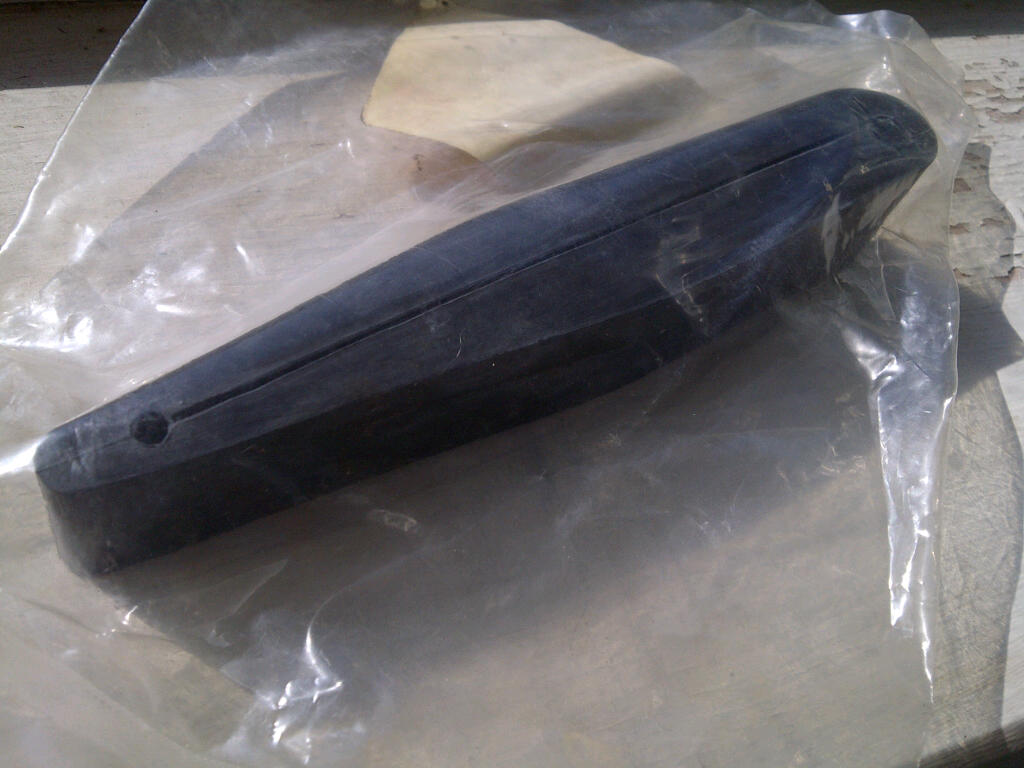

Further details will be posted as the project continues..

I'm looking at the chain tensioner pad. I am unfamiliar with it, so I may be wrong, but it looks like the face that rides against the chain is up, and the face that seats against a metal arm inside the engine is down. The sides are unimportant, but the pad would be placed into the mold material with the chain face down and the mounting face up, because that is the way it tapers.
The problem is going to be that you will not get a smooth or flat surface, or a precision thickness, with an open top mold. The polymer is going to pour into the mold thick, then cure sort of like an ice cube in a those old fashioned ice trays. There will be a dome or a dish to the face, it won't be flat, and the thickness won't be uniform from part to part or even across the same part.
The bumper cushions (for the GT), pose the same problem. The surface that seats against the bumper would be facing up in the mold, the original back has a recess in it, and there are two bolts sticking out of it that have to be located in the mold.

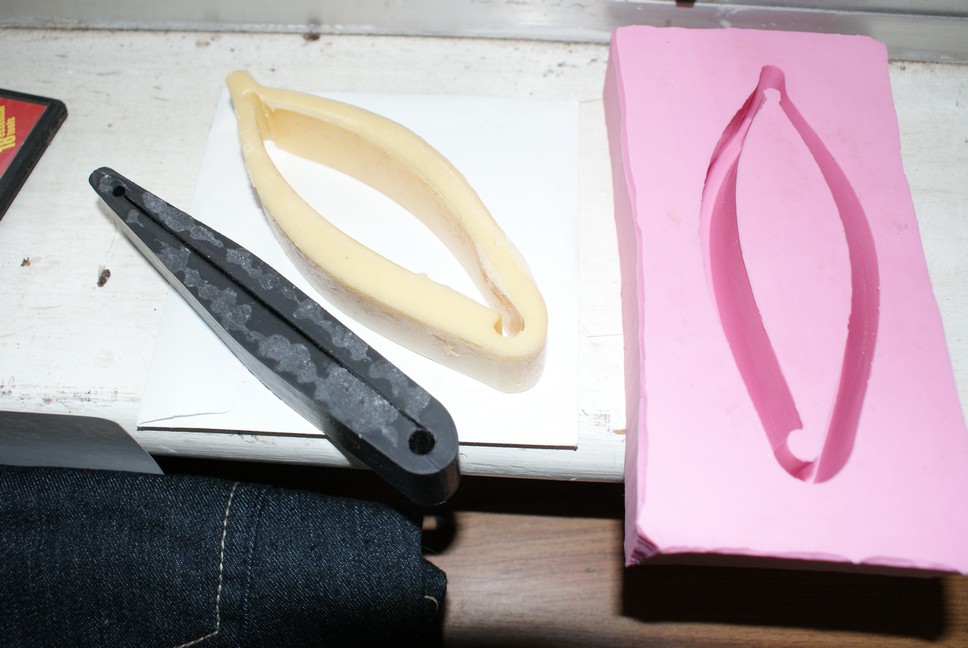

here are some pics of the first effort. Not quite warm enough for Urethane to go off as per the supplier but i am going to fit this to my auto engine that needs a lower engine re-fit.

It looks a lot different out of the plastic bag. So the side rides against the chain, not the top face.
It might be closer with a metal center wall with straight sides and the circle at the end. The curved walls to keep the mold stronger might not pull flat when the piece is installed.
This is one where measuring from the piece it fits onto is important for the inside dimensions.
