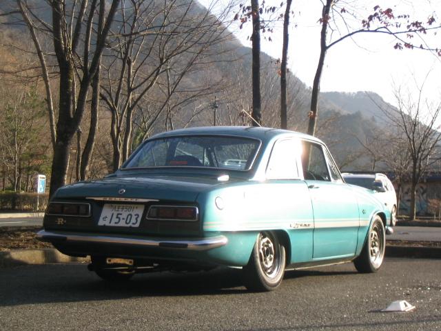

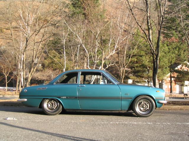

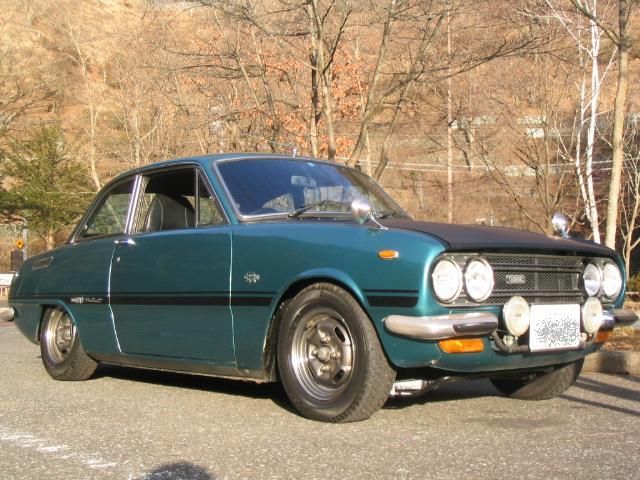

It'd probably do hellish things to the inner tread of the rear tyres, but it does look totally cool. 1) it's sticking it up at all the Datsun 1600 drivers who think crazy rear camber is their exclusive domain and 2) it looks like it's about to take on the Japanese Touring Car Championship, circa about 1969.

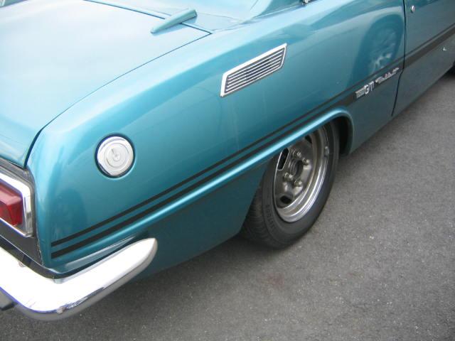

"You CAN'T be seriuos!!" that's crazy :lol: ......But has anyone noticed the fuel cap on upsidedowny so that the cover keeps falling to expose the key hole !! (pet hate). :roll:

I don't follow automotive fashion fads (tire tucking and 20+ inch wheels), or know what the suspension setup for a circuit car would have looked like in 1969. But I've been spending Saturdays for the last two years, with my less prestigious car, cranking the camber plates in to maximum, and setting front suspension to about 3/16 inch toe out, in preparation for Sunday races. With my limited experience, I would be more impressed if the rear wheels on Eagle's GTR were vertical, and the fronts were tilted in.
I also like a little rake, as in the back slightly higher than the front.

I don't think the boys at Eagle were trying to look good JT. You are on the ball with the need to get plenty of caster and camber in the front end. If you are going to start driving a Bellett fast around corners you will want as much negative camber as you can get in the rear.

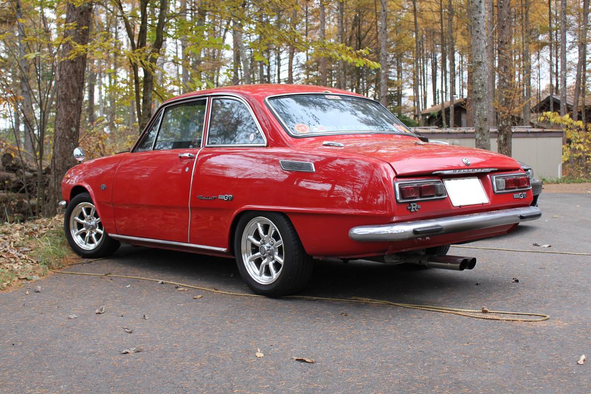

The rear wheel looks vertical to the ground. The ride height looks about halfway between original and the excessive example at the beginning of the thread.
Ignoring any idiosyncratic suspension tuning needed to make a Bellett do things that it was never really designed to do to begin with (and the things we all want to be able to do), this car looks right. If I were walking by, I would be thinking that this car looks healthy and well adjusted.
