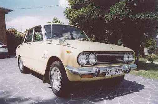

I have followed the forum periodically over the past few years and thought I’d introduce myself.
I have a 1970 yellow deluxe which I inherited from my father who was an avid fan of the marque. He also owned a 1965 model which I learnt to drive in and which just refused to die mechanically but eventually succumbed to the tin worm in about 1995.
I’ve done quite a bit of work to the “yellow peril” – a respray, re-upholstered seats, new carpet and I rebuilt the engine giving it an 82mm bore and fitting Gemini pistons, conrods and bearing. I also “blueprinted” the engine, measuring carefully all clearances and matched pistons and rods down to 1 gram. I farmed out all rotating parts to a machine shop for balancing. If anyone is considering the same rebuild, I have all the information on clearances etc. Stainless extractors completed the rebuild. The combination of bigger bore, compression and extractors gives noticeably more torque. It revs very smoothly and has only done about 5000 miles on the motor in the last five years. The biggest trip it’s done was with some friends a few years back just after the rebuild (they took a Triumph Stag and a 240Z) from Hobart over Bass Strait, through North West Victoria, South Australia and the Great Ocean Road.
It’s currently back sitting in my garage until I get the time to put the finishing touches to a mild cam installation and Weber 34DMS upgrade. And then there’s the brakes to think about……….
I also have a Mk 1 Triumph Stag which I rebuild for my wife’s birthday three years ago, a 1940 Light 15 Citroen ( all done but awaiting reassembly!) a late 30s Pontiac and a T Ford. Guess which one is my favourite…. You were right!!
I’m about to start the engine build for my other Bellett, a 1968 model destined to become a Group N historic racer. All the necessary engine internals have arrived but it will be a few months before this project begins. I’ll keep you all updated with pics.
Attached is a photo of the “yellow peril”, fitted with 14 inch late 70s Corolla wheels.
Regards
Andrew
