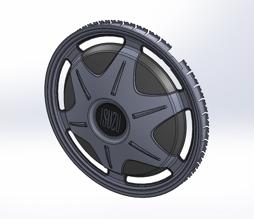

Hi all,
Just putting this one out there, as I've had to resort to recreating some parts for my Silvia, I couldn't see why I couldn't arrange to have some Bellett parts made as well. I have GT fog lamps coming, but as I've tooled up the retainer clip for the Silvia already (which I've used in this assembly), thought I might have a crack at those illusive GT hubcaps! Below is a picture of the CAD model, that's all I've got to show at the moment, although clip samples are coming and the hubcap tooling has been quoted.
SO, what I'm looking for is a show of hands, no commitment at this stage, but I'd like to know if this is worthwhile proceeding with. If I get 10 people interested, a set of 4 hubcaps will be approx. US$1,000, if I get 20 people interested it will be half that - that's with no profit for me, but I'm not fussed, as long as I don't end up out of pocket. As we know, these hubbies are hard to find and, if you find them are often damaged and can be expensive to restore.
If there's no interest I won't bother with it, so is anyone keen?
Duane

No-one? Did I over-estimate the desire for hubcaps, or are they too expensive? There's been lots of talk about unobtanium and all that, so I thought there would be more interest at this point.
US$500-600 is realistically as cheap as these would ever get, so if I can't get 20 tentatives I'll drop it and move on to 'Part 2'. I've got fog lamps on the workbench, GT horn button planned too, anything else people may want?
Gives me feedback peoples.
Cheerio,
Duane

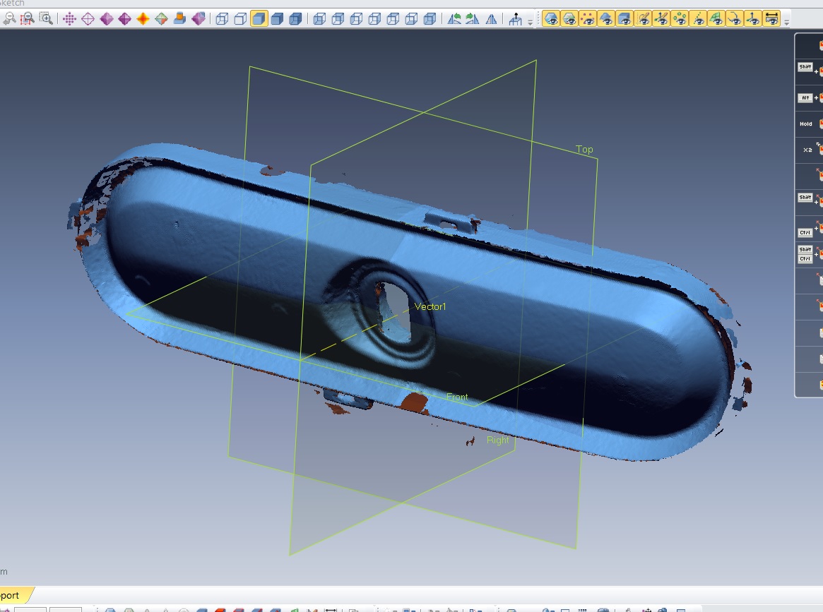

Certainly can do Matt. I've attached a scan of a Silvia replacement lens I'm working on right now - when finished the CAD from this scan will make the lens. These days they have excellent cast acrylics that mimic the properties of injection moulded plastics very well, so if you do your homework you can select the right material to make a part just as good as, or better, than the original. I'm currently testing several materials in the UV tester at work to see how they hold up under extreme UV testing.
I'll let you know what cost the Silvia lights come in at. GT strip lenses would be no problems at all and prices should be comparable with the Silvia.
The guys up in China sent me some pics tonight, so I've attached the Mazda R360 lenses; original (L), off-tool cast part (M) and final part with light sandblast to replicate the light dissipating rough surface (R). L & R would be pretty hard to tell apart had the plastic not aged on the original and gone a bit yellow. I reckon the little 'snail' front indicators that were on my GT would be perfect for this method - might cost maybe US$20ea, but would look all glossy and amber just like the real thing, with excellent UV stability and impact strength, not fragile like resin.
So, yeah, lets make some stuff and get quotes! :mrgreen:
