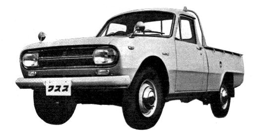

Does anyone have any idea what and where this Wasp is from? I guess it's a local market one from the '70's but it's the only pic I've ever seen?
Any ideas? Brett? Dave? What do you think??

is the 67 Wasp they had in japan.
remember that ALL our Wasp's were the 65 spec and came in in one shipment of 122 of them, so no matter if they weren't sold until 67 (like mine), they were a 65 model, so we only got the first incarnation of them.
that style front followed the 65, and used the same front styling as the 67 Bellett "B". Dave has a brochure of them. From what i can work out, the rest of the Wasp was the same as the 65 tho.

Cheers Brett! I realised ours were all the same batch but didn't realise that they'd change the Wasp straight away from the four head lights to the one piece ones.
Thanks for the info :)
Thu Sep 25, 2008 10:56 pm
Yeah apparently mine was sold in 1967 as well despite being a 1965-batch car (uh, like all our Wasps). But yeah, those Bellett-B lights are something else... I'm sure I've seen them on other Belletts as well - non-Bs I mean.

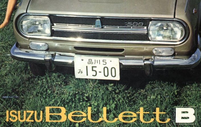

I think from what I've pieced together using my brochures, the 'square' style headlights on that Wasp seem to have been gradually introduced across the range.
They appeared in about 1967 on the Bellett B (PR30 - 1300cc & PR40 - 1500cc):
Study of Square Headlights - 1967 Isuzu Bellett B 1500 brochure.jpg [ 91.37 KiB | Viewed 17065 times ]
Then they appeared again on the 1970ish Bellett 1300 sedan (PR10). If you check the brochure section, you'll see that this car had the long, flat lights of the post-1969 models, so it was probably not out at the same time as the Bellett B, which when compared against similar brochures, seems to line up as being a 1967-model (same brochure theme, same interiors etc).

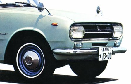

Study of Square Headlights - 1970 Isuzu Bellett 1300 brochure.jpg [ 24.77 KiB | Viewed 17065 times ]
I imagine that the Wasp seen above may have been a 1970ish model with a 1300 motor. What I can't confirm is if the Wasp 1500 then had the same front or not as the 1500 sedans (4 round lights, black mesh grille with x4 slim chrome bars), or if it was available at all!
