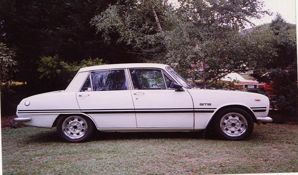

heya rob.
gather this is the look you're after??
this is my 1st sedan i owned. did the GT-R stripe thing in the mid 90's to it.
i took a guess at the width's and spacing back then, and as it turns out, it was fairlly close to right.
i did the lower, fat stripe at 2 inches wide, a 1 inch gap, then a 1 inch stripe on the top.
the lower one then thinned to 1 inch over the wheel arch and along the quarter to match the top one.
i measured a 1/24 scale GT-R model kit i have here, and although the measurements are small, once you multiply them
by 24 (to get the full size scale), they came out so close to the sizes i use that it didn't matter. were talking decimal places!!
hope this helps.
btw... the badges i used on the front guards and the rear under the RH tailight are actually Monaro "GTS" ones.
i was going to use Torana "GTR" badges, but then i thought.... it's not a GT-R, let along a coupe, but it's a sedan, so does that make it a "GT-Sedan", or "GTS"..........????
was something a bit different in the end.
cheers.

Awesome that is very close to what I was thinking of doing. Kinda thought somebody must have been there before.
Many, many thanks for the info.
Like the GT Sedan thoughts ... after all it will be a Grand Touring Sport sedan :)
Happy New Year :D
Fri Jan 01, 2010 12:50 am
no probs mate.
feel free to do the same!!
I used HK/HT/HG Monaro badges, and left the "GT" in black like a 1600GT badge, but I painted the "S" in green to match the "R" on a "Type-R" badge on a GT-R.
Mind you, if I did this all again (which will probably happen on this car again for my Dad), I'd use HQ ones.
The HK-G ones have very "square" letters, in that there's 90 degree corners instead of radius curves on the "G" and the "S".
The HQ ones are more rounded, and the "G" is more in line with the "G" on a 1600GT badge.
Also, as the HK-G is the best known and liked Monaro, the badges were easily indentified by all and sundry, so it was obvious what they were off, where as the HQ badges would (IMHO) be more exclusive and harder to pick as not being off a Bellett.
Having said this, the HZ GTS badge is a very pretty one, and much smaller than the HK or HQ items, so that might suit better as the HK and HQ ones are bigger than any Bellett GT badge ever was.
Food for thought I guess.
Cheers.
