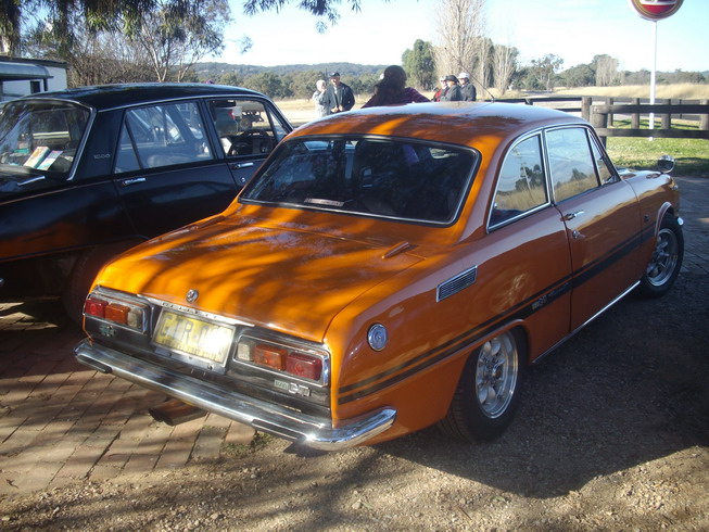

Postscript...............
Sedan....
G.T. (& GT-R)....
Fri Apr 01, 2011 12:28 pm
:D Matt what a great photo,to park alongside a GTR,got to be on any Bellett enthuzast's bucket list,Gerry has learnt to down size photo's,but still needs the young one to guide you through the mine field,hope to post a few next outting 10th
