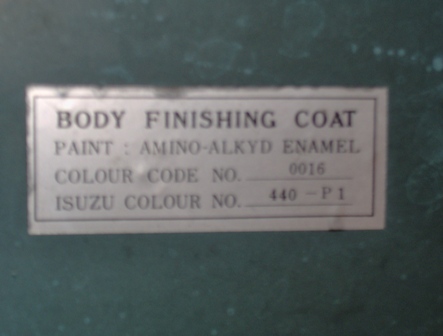

Hey All ...
Thanks for the paint code listing JT, here is the lable from under the bonnett of the PR10 .....
Later
Mark

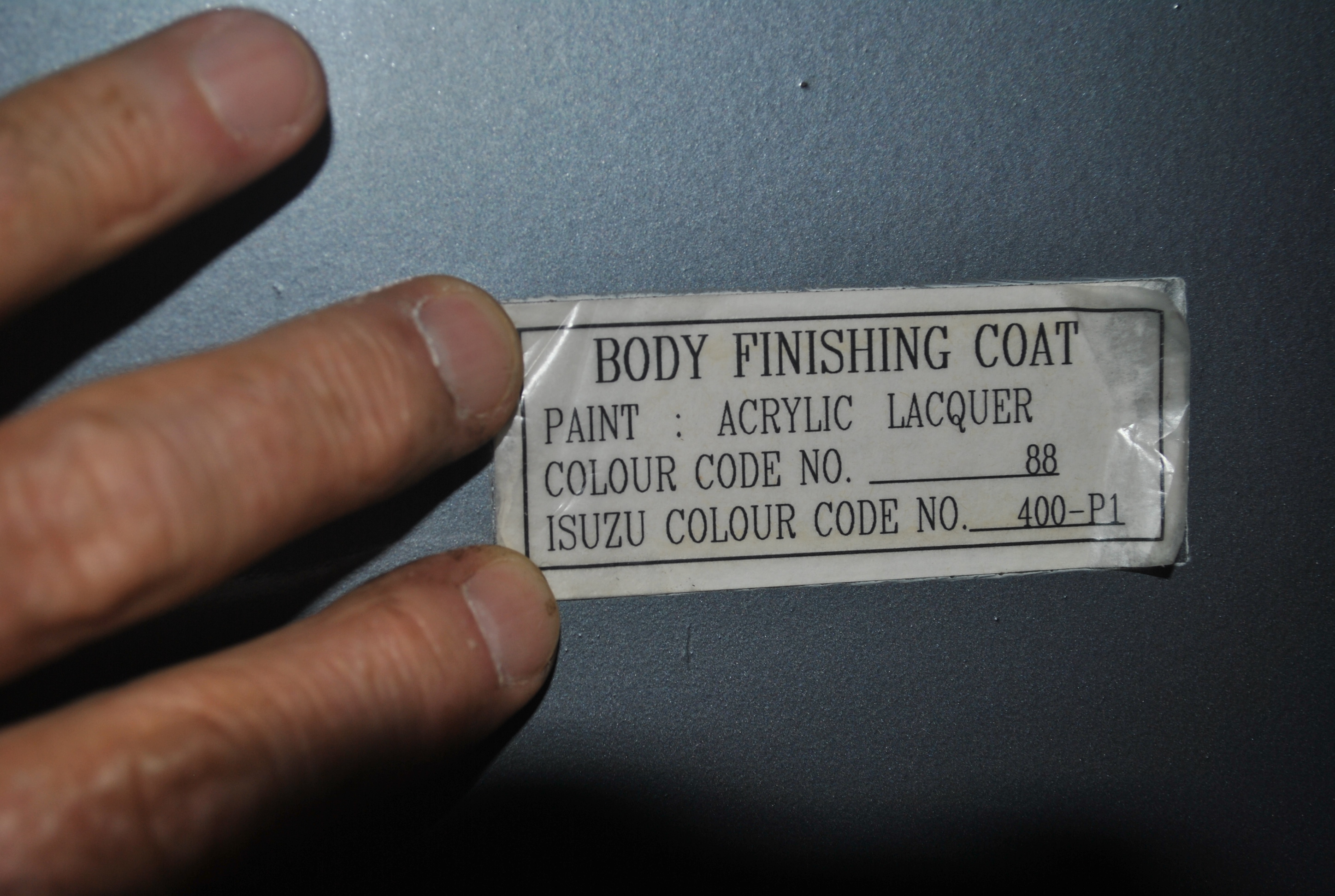

Hey Brett, does your listing have my paint tinting quantities? Code 88.
