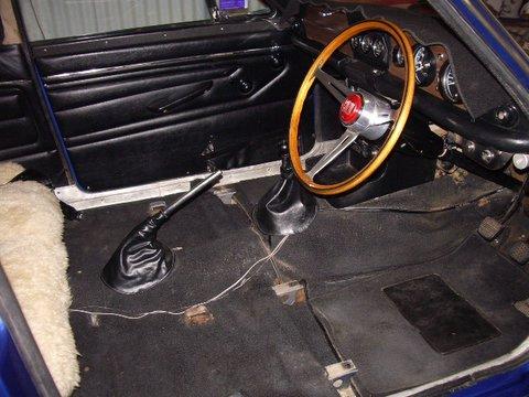

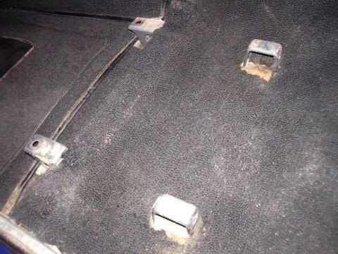

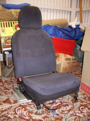

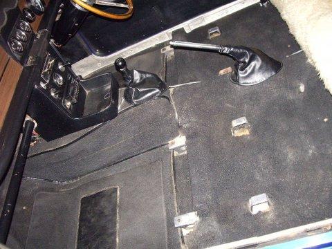

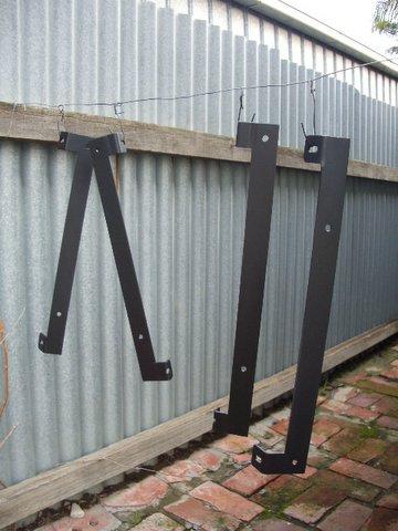

Into the third week of replacing the original (violet crumbled) seats in the GT. Got these seats cheaply from dismantlers Jepps Cross. They fit and siut, only problem is the runners and mounting points are offset and completely different from the originals. Soooo...

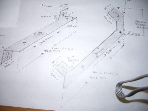

The measuring and drawing of adaptor plates. I got them back from the metal fabricators today and quickly learnt they had missenterpreted what I had told them in a 20 min conversation in detail. The opposing seatbrackets weren't a mirror image as requested and some angles were missenterpreted. Anyhow, a quick trip back to them and we can rebend and modify the existing brackets. :oops: not happy Jen but its all about perseverence. Meanwhile, back in the "bat cave" some pics of the empty GT (MT GT). Brad on the floor, the old seats (don't take the covers off, aagh, violet crumble all over the shed), the new seats (much like what i've seen of a Late model GT). Should have revised brackets next week. Wll put next pics up when installing.

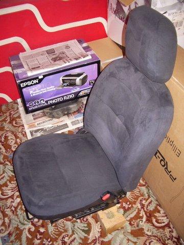

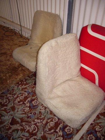

Here are the seats to go in, sorry had to post again (poor "E" literacy skills)
Bear with :roll:
B. 8-)

Mate, no good when you spend a lot of time explaining what you want, only to get back a daft draft. Maybe they need to spend a little less time making pretty pictures and a little more time listening to the client. Anyway, by the look of the Epson box next to the new seats, which I can only assume the contents of which will be fitted to the gt at the same time, you'll be able to assist the boys in blue by offering to print a copy of the infringment notice on the spot, and if they say please, throw in a nice head & shoulders for their wife.

Geez Paul...Thanks for the encouragment :lol: (and witt). I threw the epson box in just to get that kind'a comment. I figured compliance might be an issue, but my moderate driving style shouldn't attract much attention. (did I say "moderate" and GT in the same breath? :? ) The aim is to improve driver saftey and comfort although legallity is questionable. In the worst case I can still put the old seats back, and maybe one day I'll afford to reapolster. Oh, and the pretty pics are my hand drawn drafts as well as the 20 min explanation (and they still got it wrong :cry: ). Hope mark II is a goer.

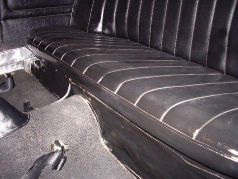

Much valuable info "65, Definitely retractables down the track. Mark II brackets not without dramas though. Ther'e still not understanding "mirored" instead of "replicated". Meanwhile, Iv'e been doing some cosmetics while the seats are out. Polishing the alloy skirtings along the door sides, cleaning and blacking out the rear seat frontice, some armourall'ing etc.

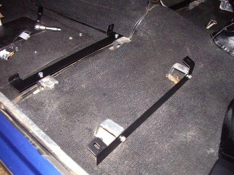

Seats are in !!! Pics of the fitting stage on Mon 29th (usb sitting at work)
Fri Jun 26, 2009 2:54 pm

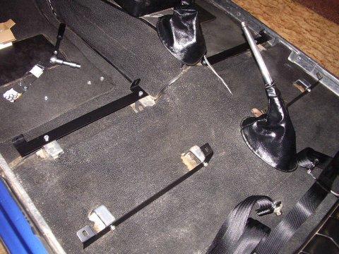

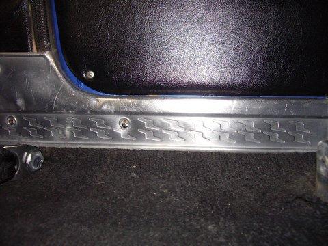

hi guys, as promised pics of the fitting. Also polished kickboard, seat belt mountings, rear seat enhancement...

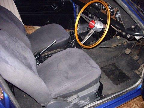

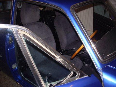

And the finished item.
Some purists out there might be offended :shock: but it's a more controlled driving possy, and way more comfo than sitting on your arse throwing ape arms.
Only thing is the seats are raised and just touch my hair on the roof lining, 5 ft 10..1/2. Great for small japanese guys. The newies should settle with time. Meanwhile, heaps firmer and straighter than before.

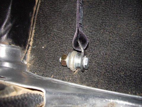

Hi, I am restoring a Hillman Super Minx Estate Wagon and it originally came with only front seat belts. Did you install the belt anchors yourself? if so, how did you do it and do you have any pics. It looks a lot neater than the original mods where you have to drill large holes into the floor and use 6mm backing plates, etc. Thank you, clyde
Wed Jul 01, 2009 10:35 am
Hi Clyde. Just had a detailed explanation ready to submit, but bellettnet and the internet disappeared on me, Bummer. Here goes again, maybe the abreviated version.
Lap belts, are a kit, from any auto accessory place. Autopro $75, and the full sash $95.
Look at the close up of the belt mounting point assembly. The rounded non shiny bit in the middle of the assembly is the original rear floor pan "eyelette". these are bolted into the floor and need a sledge hammer to even start moving them. The rest of the assembly are the bolt, nut, spring washers, alloy bush (through the centre of the assembly, allowing the belt to swivell for the sraightest pull in an impact, god forrbid) and large washers, all supplied in the kit. Instructions with the kit are good. I'll post a pic or two of the assembly loosened up, as this only takes a few seconds to dismantle. Depending on the original mounting points of whatever classic you have , may depend on how you configure the assembly provided in the kit, or choice of either lap or full sash.

I don't wish to be negative here but the mounts, especially at the front have no provision to stop the bracket twisting. ie if you fit the seat and press down very hard on the front, (or have an accident with forward shifting loads as you slide fowards) ) those brackets will want to twist downwards.
