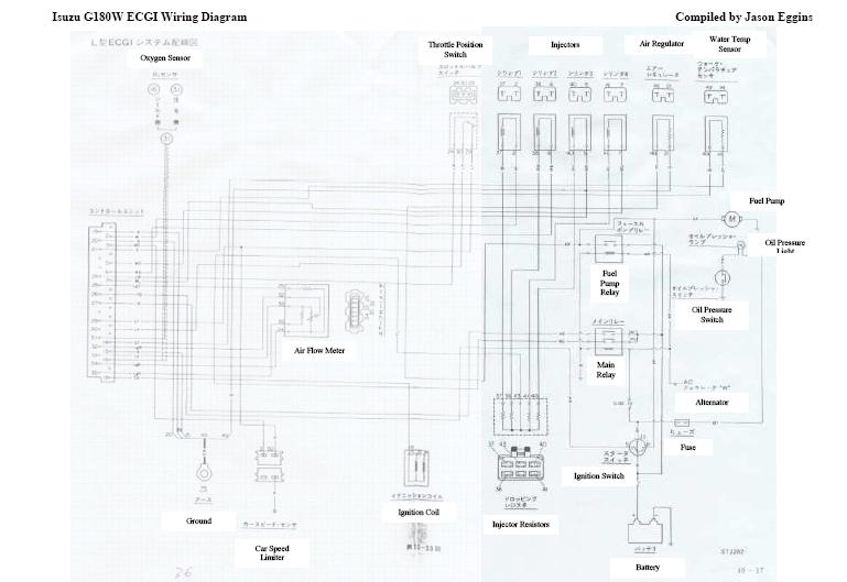

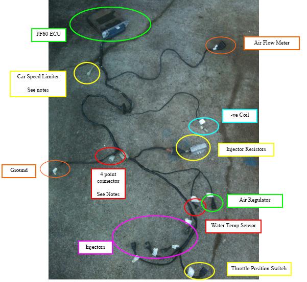

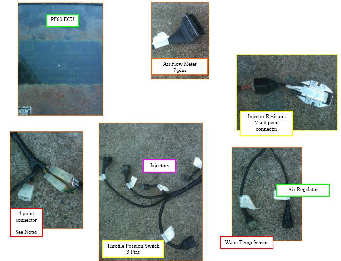

I have created an english version of the japanese wiring diagram for the G180W ECGI engine. It's based on compiled translations and many hours of working things out with the loom in front of me. It includes the wiring diagram with translations and a series of photos of a standard ZZ/R loom from ECU to all the individual plugs with labels. I tried to login to the isuzu twin cam forum to put it there, but it wouldn't let me for some reason...
It's a pdf file. I don't have any file hosting capabilities at the moment. If anyone wants the file, let me know. Perhaps someone can post it to here so it's available. Hopefully it will help a few trying to sort out the wiring associated with this engine.

Thanks for all the work & the offer Jason. If you can email it to me I might be able to convert the file, I'm a toddler with 'puters but I think this does it. The diagram could be very useful to me too. Thanks
Sat May 22, 2010 12:25 pm
O.K.,here we go. Jpg converted, hopefully the right size. Thanks Jason for all the work, and for shareing.
