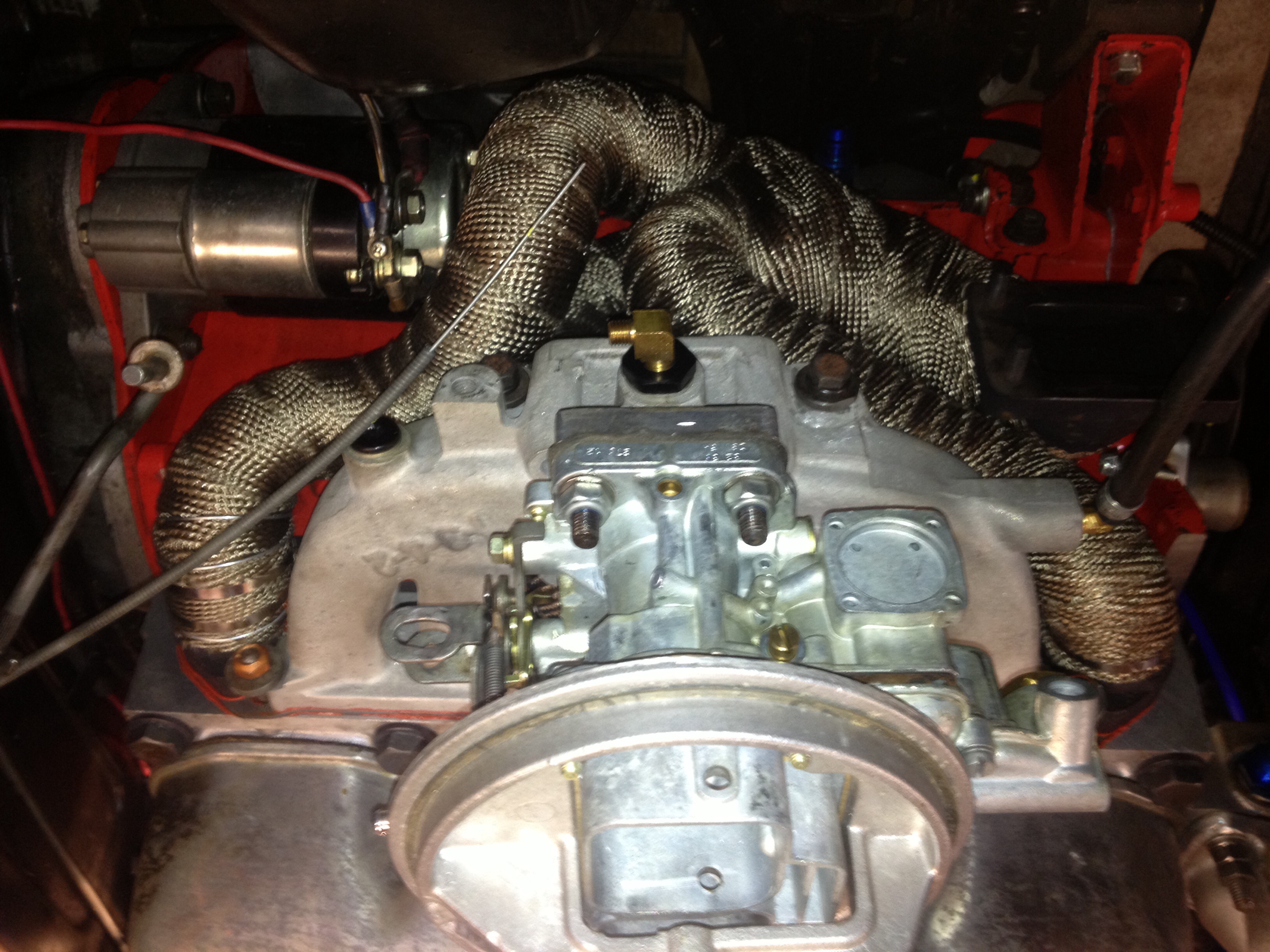

Hi
Great carby for G161
Standard getting of 32/36 DGV with manual choke
140 primary jet /135 secondary jets
165 primary /160 secondary air corrector
Idles jets 55/50
I have a lumpy cam so my set up is
135/145 jets
150/150 air corrector
Idles 55/55
Note 6 grades of air correctors equates to one size fuel jet
Here is a great link on how to tune. Once set up shouldn't need to adjust for years
http://www.datsun2000.com/tech/weber_tu ... dology.htm
Re linkages simply remove the end of the throttle linkage from the Nikki and bolt onto the Weber..... Job done
Don't run more than 4psi fuel pressure
Re adaptor plate may need to port match to the carb with a round file..no biggie
J

Hi
I think you may have a Gemini g160z motor????
Mine is a Bellett G160/161 motor
Bellett use throttle linkages and shaft rather than cables. You can see the final throttle shaft in the first photo disconnected
If I am right then I don't know as the only cable I connected was the choke which I later removed as on the 32/36 weber it's pretty well useless.... 2 full slow pumps of throttle on cold mornings, hold throttle 1/4 way, turn key and fires right up
If I am right then perhaps you could contact
GEM Parts on eBay, just type in weber 32/36 as they supply heaps of parts
If you do indeed have the Bellett Motor then I sources longer bolts and spaced the final pivot block away from the fire wall and moved the lever arm along the final shaft.....later on I came across a Thicker pivot block from a GT I think and returned it all to origional mounting points on the fire wall
J

Ah yes, I see the differences in the linkage.
I definetely have the G161 OHV motor however in a Chev Luv the throttle is cable operated. It has a bracket that mounts the outer cable and creates an adjustment point and there is a barrel style knob on the end of the inner cable which connects to the throttle wheel.
I have the carb mounted and everything but the throttle cable connected now. I will have to fab up a bracket to mount the cable stop off one of the manifold brackets.
Thanks again.

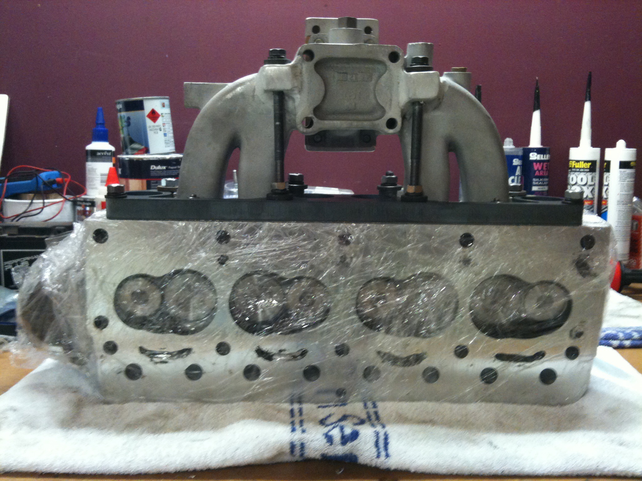

Whats the intake manifold in the pic ?
Fri Nov 27, 2015 9:49 am
Posts: 428
Location: Sydney NSW
Florian / late g160 square port Bellett

Posts: 57
I made a bracket quickly to support the throttle cable stop. Not the prettiest setup but it works.
Will need to change to a solid inner choke cable as it won't disengage when pushed back in currently.
It runs though. And sounds quite happy after a quick idle screw adjustment. Haven't taken it for a drive yet as The aircleaner I had wont fit with the manual choke in the way.
Fri Nov 27, 2015 10:14 pm
Posts: 57
Rigged the aircleaner with a couple of zip ties.
Can report that it runs rather well. I think the primary main may be a tiny bit off but all in all, much smoother than the Nikki and no air leaks!
Can't detect a whiff of power increase whatsoever however I didn't bother to match port the manifold and there is certainly some porting that could be done.
