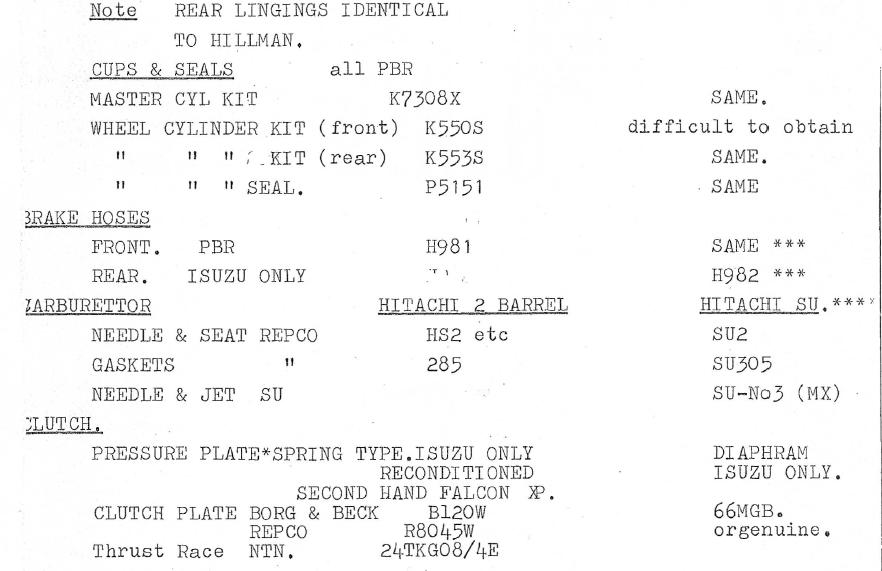

BCCV published an equivalents list many years ago..... here is an excerpt showing the Clutch
(rh column is GT)
from that it appears MGB is only for the clutch plate. Most 'good' clutch places should be able to reco the pressure plate.
I had one done in the past by BGT brakes in Dandenong.
the *** in the listing means untried i think ?
Fri Sep 19, 2014 6:06 am
