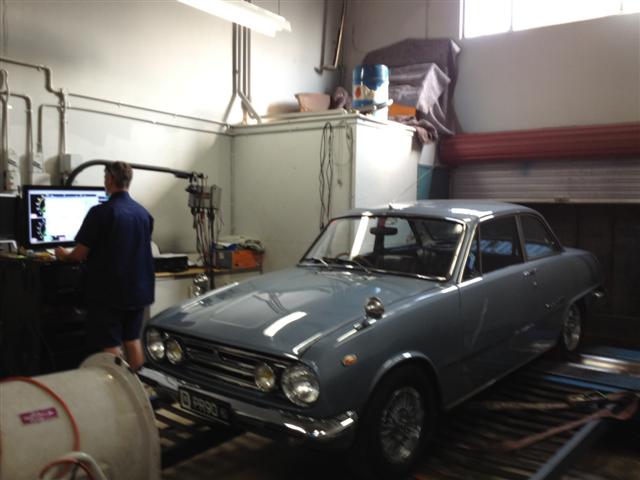

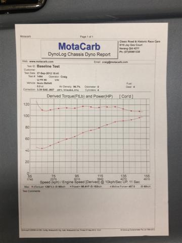

Just had my carbies tuned and the car is running sweet, Out of curiosity I had Rufus run up on the dyno after the engine rebuild (plus 600km). Interesting that he made 98.4hp@4900rpm. Seperate test to 5200rpm 170kph showed a level off.
It only has a mild cam 1/8" bigger extractors and a bit of porting. Carbies are too small to achieve any more power. Not bad considering manufacturer's specs show 91horses at the flywheel 8- Good flat torque graph too, higher than manufacturers rating.

Thu Sep 27, 2012 8:23 pm
Hi Lewis
Are you happy with the performance, did it make a lot of difference?
Geoff
Sat Sep 29, 2012 8:25 pm
car looks good ..... all the work you have done on motor and only gaining 7 horses over standard not good :roll: you would expect more :D
Sat Sep 29, 2012 11:02 pm
thats rear wheel HP, not quoted engine power. There are losses in the trans. so the rear wheel HP measured is pretty good I think.
Sat Sep 29, 2012 11:46 pm
Thats a big improvement the best guide would be research whp stock on 13 inch wheels/tyres ;) i think you would be supprised.
Sun Sep 30, 2012 8:36 am
Yeah Geoff, considering a manual transmission car typically loses 16% of its flywheel
horsepower that means my engine is producing 133 net HP at the flywheel, whopping 45
more HP than standard G161. Greg, I am running std profile 13" wheels.
