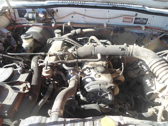

Jackaroo ECGI manifold to a G200 DOHC engine?
Anybody know if the inlet manifold from a Jackaroo will fit on a G200 DOHC engine ??
they look similar but I am not sure if the engine side will be the same? (probably not !)
If I can get the 117 engine it has the manifold that won't fit a bellett. Need to change to the ECGI type.
File comment: Jackaroo 2.6L engine will manifold fit a DOHC engine ?

answer is NO fit
Sat Aug 04, 2012 7:41 am
Bugger.....
not even close ?
adapter maybe? cut and shut ?
thanks Greg

I'm looking way in the future here at moment. Prime reason to get the 117 engine is the gearbox with idea maybe one day to fit the DOHC to 2nd car if it proves to be worth re-building.
Was planning to go the Astra/Camira Delco computer conversion route for the efi. For that i need the ECGI type manifold or 2nd choice, make my own but that won't look 'factory'.
Or if can find some GT type carbies, just fit them !

I have a mould to make weber manifolds for them. If you need a set made :?:
Sat Aug 04, 2012 9:18 am
Sounds good. Like to do the EFI but carbs probably simpler to do

nope. manifold isn't even close.
those 4z series manifolds are interchangable with G-z gemini series engines tho, and we all know they won't fit a G-w.
Glenn.... how bout Weber manifolds with 4 throttle bodies? gives a carb look and sound, but advantages of EFI.
