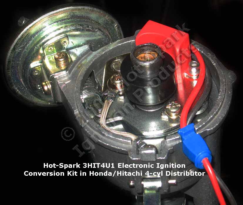

Electronic points conversion
Thanks to Chris for finding this.
Now the 64 Bellett dollar question (they are worth a million afterall :D ).
Has anyone had any experience of these.
http://www.hot-spark.com/1-Hitachi-Distributors.htm
They seem to be a reasonable price (even coming from the US).

i'd say you'd need to be the trail blazer rob!
but my advice... i'd still be getting the whole distributor reco'd and recurved, as putting any electronic conversion in one that hasn't been checked won't fix the problems by itself.
cheers.

hey rob, just a suggestion mate....
that electronic conversion looks like a simple points replacement idea, and doesn't require a total re-hash of the whole dist. obviously there would be some wiring mods to the coil tho, but the other dist. internals stay untouched. am i right?
if so, how about getting the dist. reco'd first, with the points in place, as that will make a big difference, then get the elec. conver. when the funds allow later? that way, youre not going to waste, or even compromise, the new elec parts in a dud distributor.
honestly, i reckon a reco and recurve will do more for your situation than just an elec. conver. at the moment, coz while elec. is always better, points are still OK if you keep an eye on them.
a thought, is all.

The Hot-Spark points conversion works great.
Just bolt in and away I went, the ignition was about the only thing that didn't miss a beat in 2000 odd km's.
I didn't get the distributor recurved or rebuilt thats for later. I just used the best pieces from all the distributors I had laying around.
Just make sure you have the correct coil to suit the conversion.
I got to together with a couple of others on the forum and we bought 3 sets to bring the postage costs down.
Highly recommended conversion.
