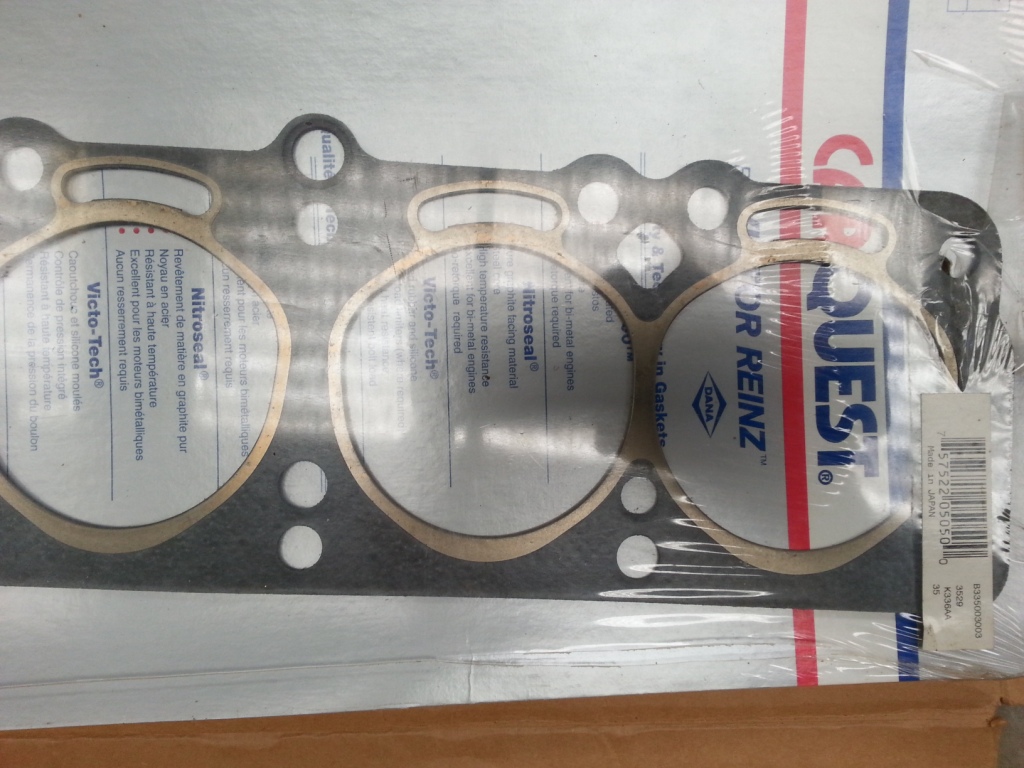

Can G161 SOHC be changed to standard G161 ?
Sun Feb 23, 2014 2:19 am
You would need to check if head bolts line up and there is room for the push rods? Assuming the OHV cam shaft would fit?
This is part of an 1800 SOHC head gasket you could compare with the OHV gasket.
