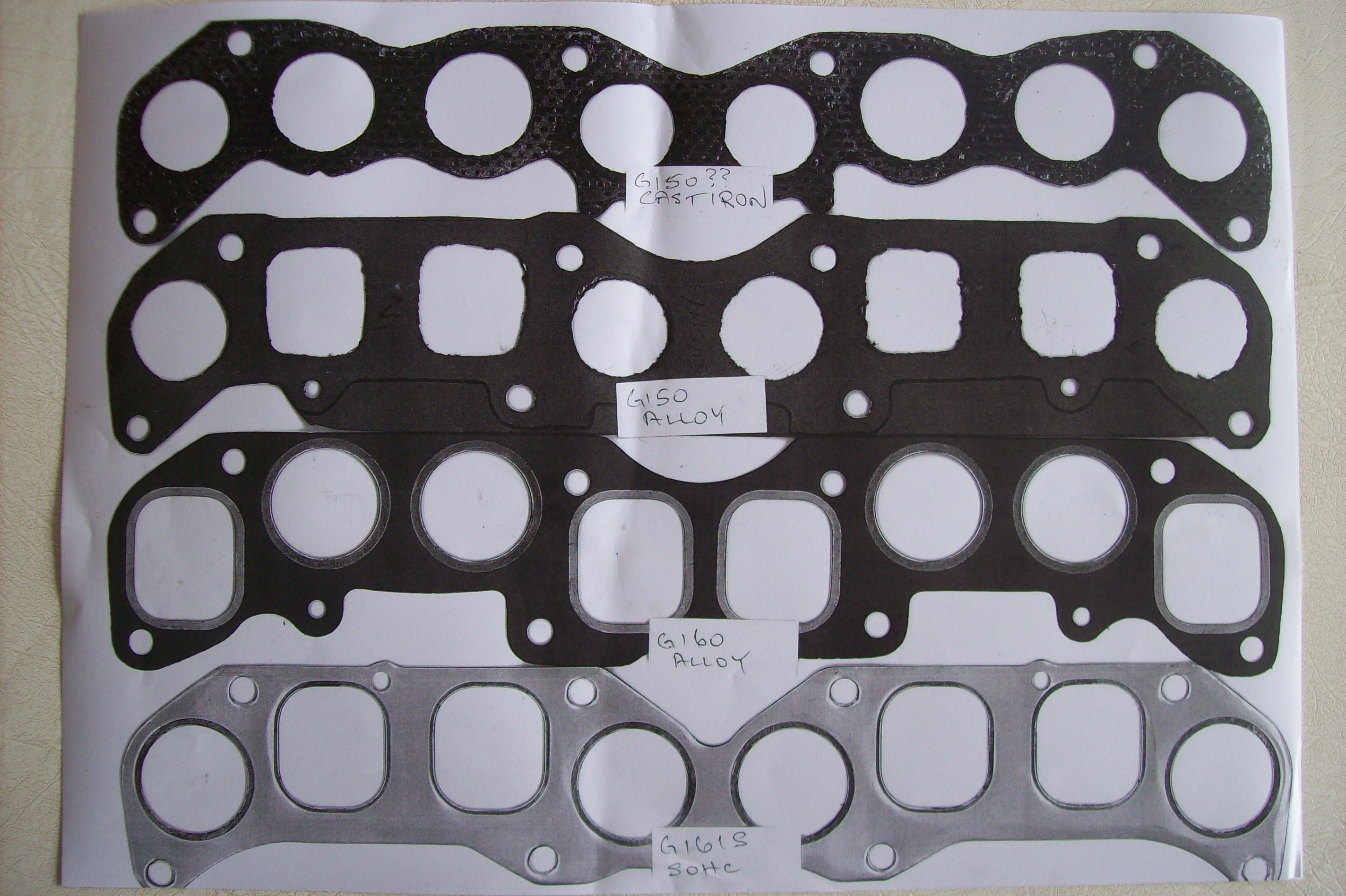

mrflibbels.
Just to give an idea of what I've come across in my possesion over the last 20 years or so.
File comment: Some manifold gaskets.
Thu Jul 09, 2015 1:23 pm
thanks for putting those up CQGT, pretty sure mine is the second one down from memory, been too cold here to go out and pull the manifold off!
Thu Jul 09, 2015 10:01 pm
Interesting, it appears that all engines use the same bolt pattern and spacing?
