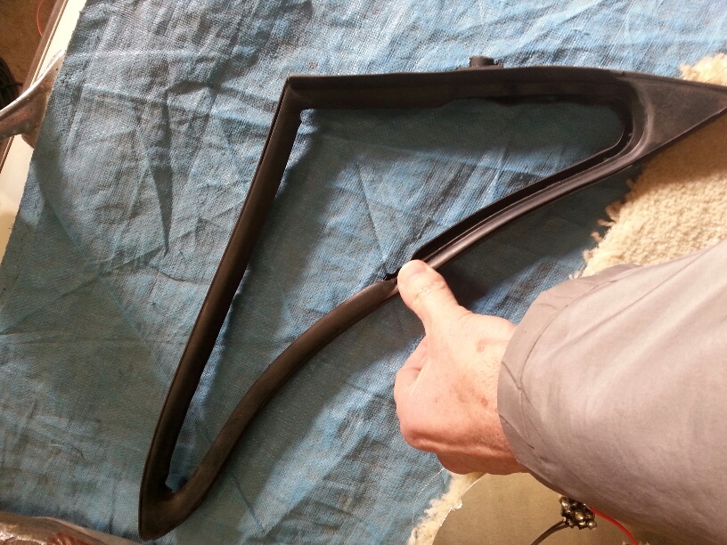

so guys hwy im a muso will the g161 luv pump fit my 1600 gt pr90 3 bearing motor ??? also what does one fit for the rubbers that the quartere window sits on its a flat channel type rubber ??? here i go again....the car is well semi gutted i am staring to know the ins and outs of a gt ...so small inside ...hardly room to turn around inside it i have the tank out and being sandblasted and cleaned also new radiator core the tanks are good ..the chrome is being done ...its all planning have all the bits ready to go then can start on panel/paint/motor /exaust and re foam the front seats brakes ....ah its great fun i have a 100 plastic bags full of bits and pieces to match ....once its all done .....it will look great .... i will be asking questions from time to time and appreciate your advice cheers davo

do you mean front quarter windows, Dave? Used to be able to buy the whole rubber (triangle shaped) Maybe even still available ex japan.
I am not aware there is a lower section of rubber only.

I have these rubbers for my Sport to be fitted.... called "weather strip" on the bag. Now i seem to recall the earlier cars had a flat bottom "U " shaped rubber piece ? Unsure how that fits in with the rubber around the actual window though, Dave.

Yeah Davo,
I have fitted a pair of these front quarter window rubbers to my PR90 last year. I had to modify them by cutting off the pointy front and shaping them into a smooth curve.. To fit them it is also best to completely remove the quarter window so the rubber can fit in one piece.
