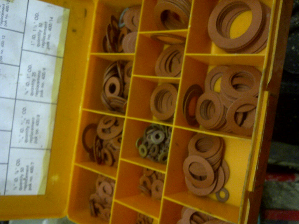

most float systems work quite well even when old and brass washers are found at car parts and carbi suppliers.
also can use red fibre type washers like this Grab Kit pictured below as dont get effected by fuel.
Good Luck
