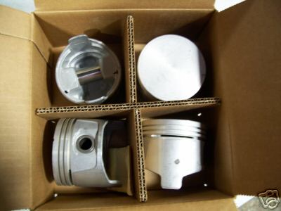

Peter, all the pistons on ebay seem to be dished type, except this one which is a flat top, so might do the job. But i am unsure if this fits the SOHC engines by the description. Although "series 1 -4" would seem right.
"110(1.8 Liter) GMC LUV Engine Piston Set 1972-1975" Brand New!
For 1972-1975 1 Thru 4 Series
2 Sizes available STD, 020 Over
http://www.ebay.com.au/itm/110718451910?ssPageName=STRK:MEWAX:IT&_trksid=p3984.m1423.l2649#shId
LATER UPDATED:-the pistons shown in the picture: says 3.3871" bore which is 86.03mm. Too big for a 84mm bore.

86.03 equates to ~1906cc from the 84 x 82 SOHC 1800 engine.
The above pistons are flat top on ebay but no rings with them. Is it feasible to get rings for that size
Is it safe in all cases to punch them this far or is sonic testing first needed.

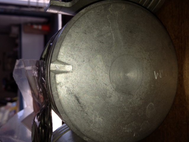

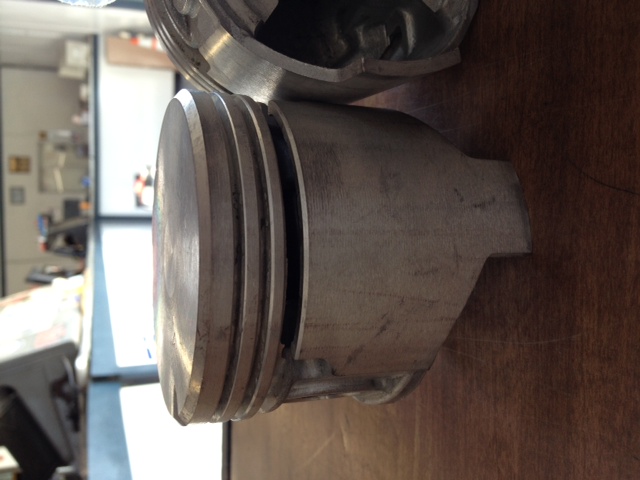

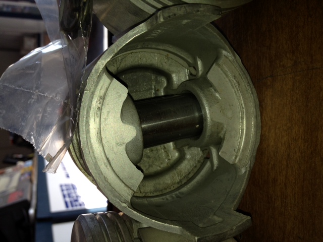

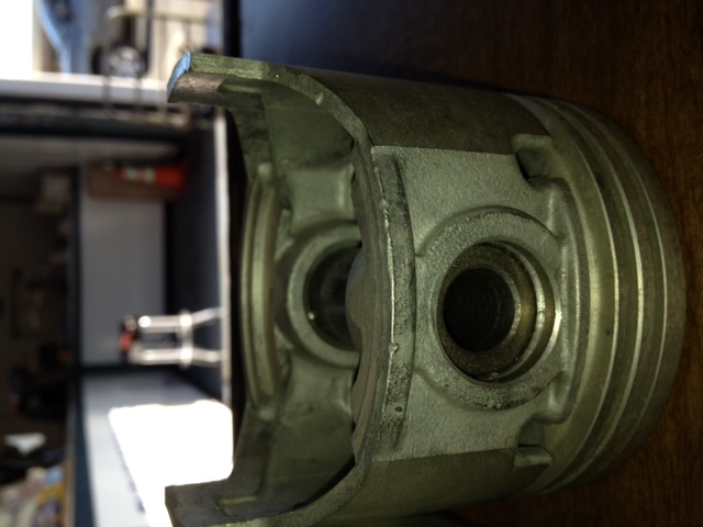

I found these pistons, can anybody comment on them please?
They are supposed to be for the SOHC 1800cc engine, Series 1 - 4 Chevvy LUV in USA.
They are domed on top. >> updated:- Must be my eyes, vendor says they are flat tops.
Not 'shiny' looking either like others on eBay.

They are 84mm +20 thou'

I now have this info on the pistons, (appears to be +0.5mm or 20thou over)
P405 X .50mm or .020 in
Standard bore: 3.3071 or 84.0mm
Compression distance: 1.445
Ring pack: 2@2.0 1@4.0
Head type: Flat top
Pin diameter: .8664
For 1972-75 engines (1thru 4 series)
can anybody cross ref this to a SOHC engine or Gemini/Rodeo to see if Ok for SOHC 1800 ?
Please.

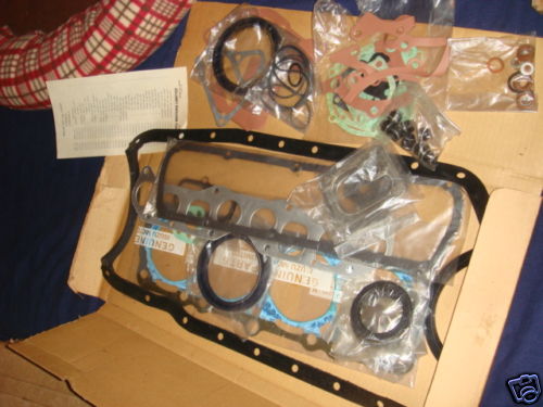

I took a plunge here.
Bought Luv series '72 - 75, flat top piston set. +30thou. OK, not 'right' pistons, but better than dished ones.
Rings and full gasket set. Hopefully right one see below, appreciate any feedback !
Just need a car to go with them !

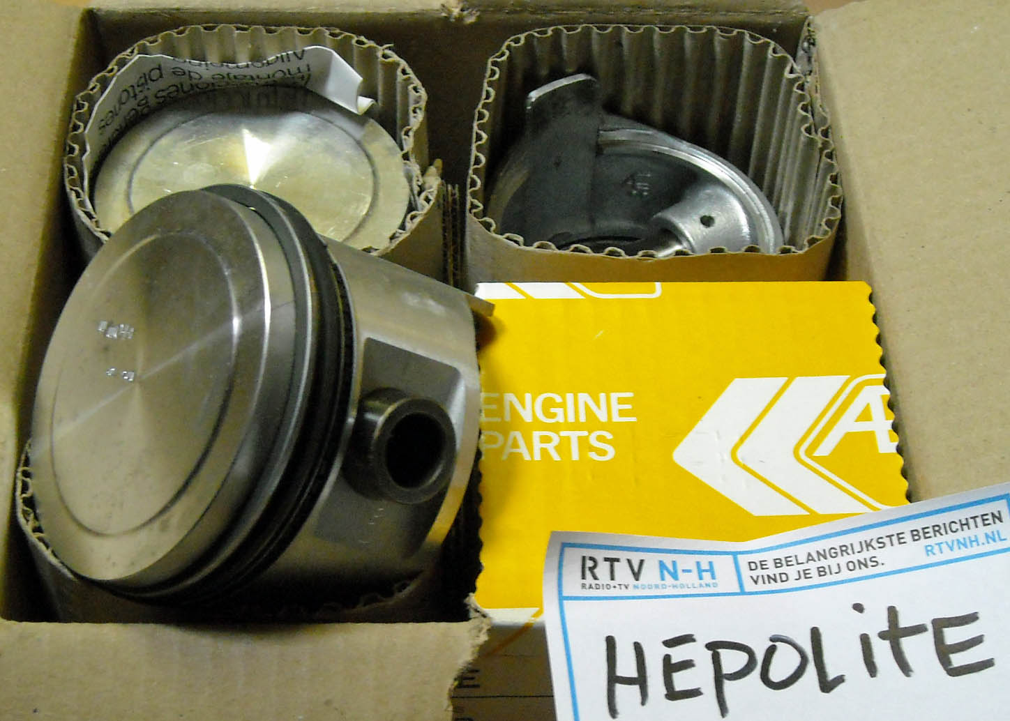

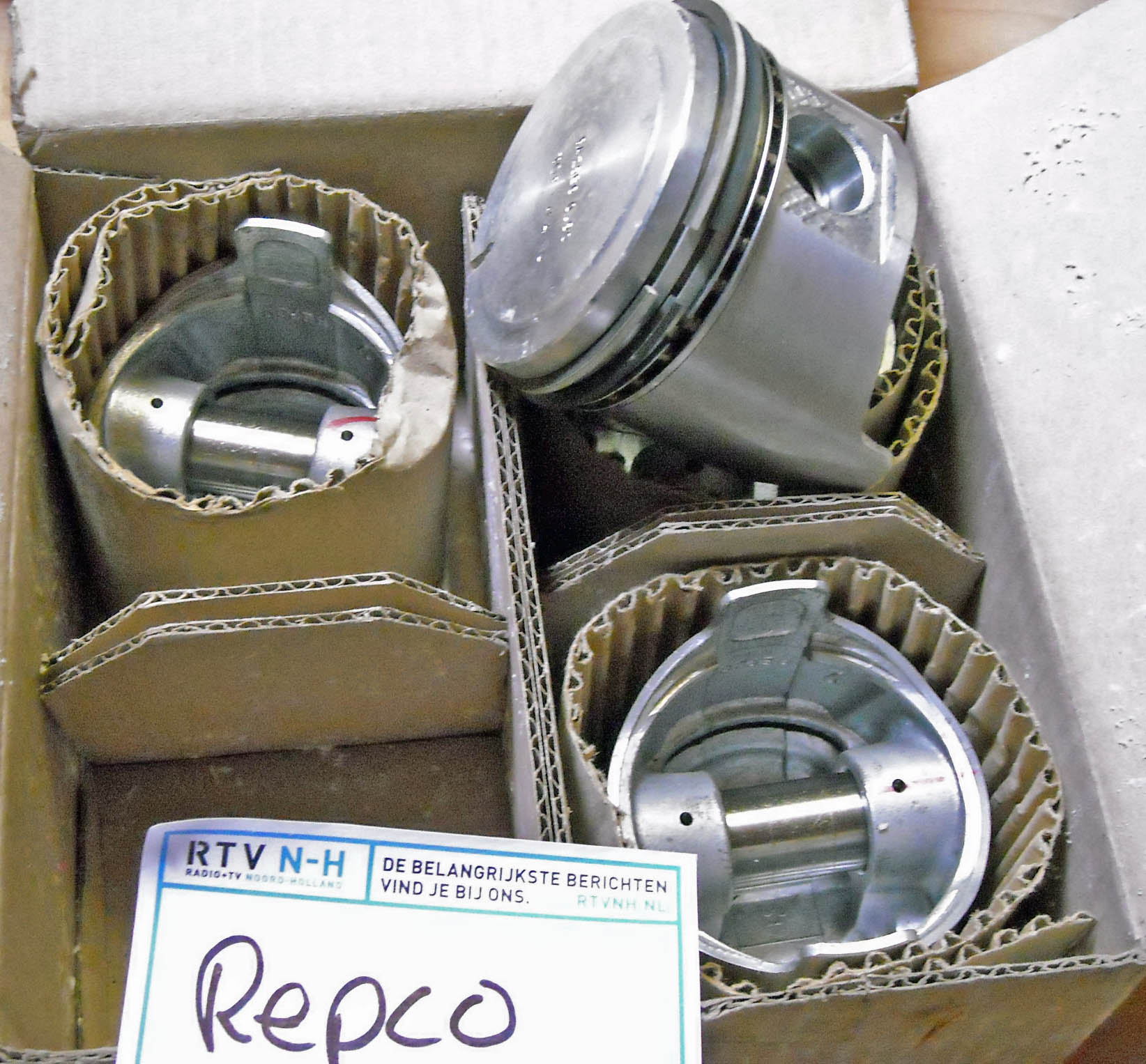

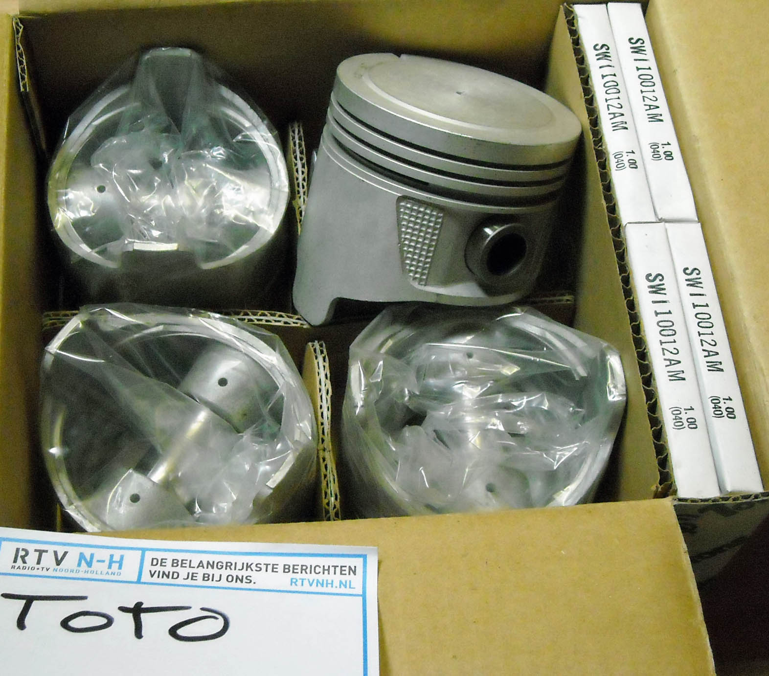

Hi Glen, as promised some pics of pistons that Dutch Dick sent me, when I was looking around for them myself.
Hepolite
Repco
Toto
These would make nice Christmas cards as well :)
Fri Apr 20, 2012 10:44 am
Mark, are they 84mm pistons? I guess not if for Rollie.
Fri Apr 20, 2012 11:36 pm
Posts: 95
Hi Glenn,
The pic's Pombellett shows us are pistons for a 1600 (82 mm pistons) indeed, I also do have the 84 mm pistons. They look just the same with he little step on top of the piston too. This offcourse will give a better compr ratio.
The original sohc pistons had the cam on the piston not only for higher compression, but also for the flow in the chamber.
I'd say; now it is getting time to go out and buy an 1800 sohc car. With a bit of luck it has a good engine with no work at all !
groejes Dick
