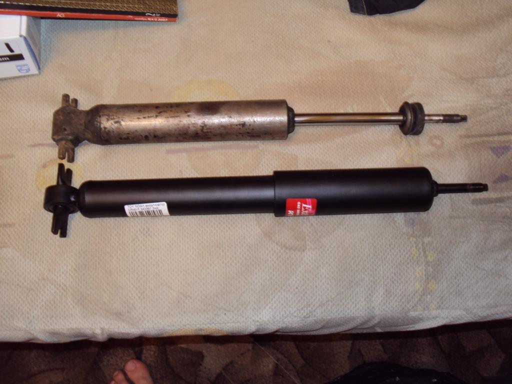

I bought absorbers for toyota noah. I think they approach
File comment: original shock absorber, and KYB for toyota noah.

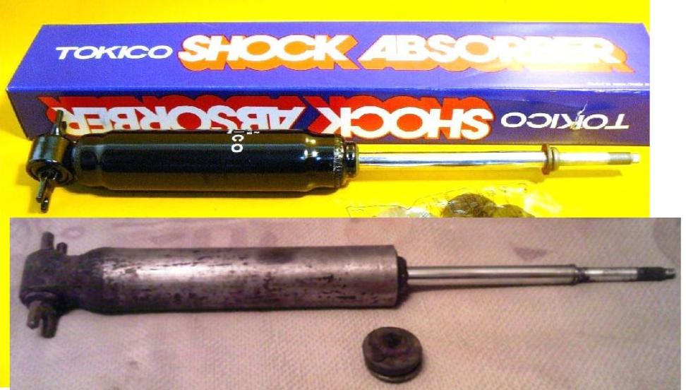

File comment: original shock absorber, and for toyota crown s141.
Thu Nov 12, 2009 9:43 am
looks very similar, i have no idea what a toyota noah is though! look like toyota hilux/hiace front shocks - also very similar to some mitsubishi and holden front shocks!
