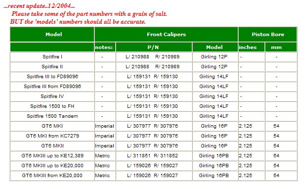

I don't have this part but it looks similar to the GT. What is GT caliper piston size ?
Uses a solid disk too.
This one is 54mm piston size (~2 .125")and from Triumph GT6. There are a couple of verisons with metric or imperial fittings. Mount spacing might vary too. Don't know what it is.

Would be interesting to compare to GT in the flesh so to speak.

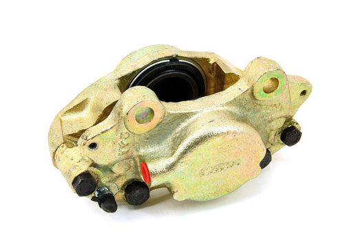

Mon Apr 16, 2012 12:14 am
another shot

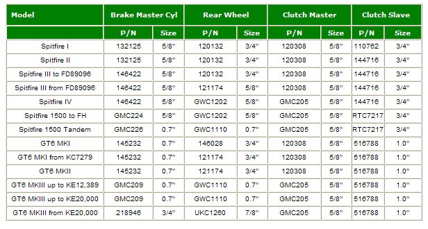

I was wondering if this whole caliper could be fitted instead.
I am no brake guru though so not sure what effect this would have with smaller piston size. Presumably more pressure needed. Pads might a be a bit bigger than GT's though. Assume the donor is a little heavier car also.
master cyl size etc of the GT6 is as below...
Triumph GT6 twin spot calipers 16P etc 54mm d pistons.jpg [ 63.81 KiB | Viewed 20807 times ]
The previous thread was more about finding another car with 2 1/4 inch caliper pistons for donor rebuild parts. But the difference in the size of the piston remains a problem if the plan is to substitute the entire caliper.
It has to do with the fluid capacity. Assuming the original brake system worked well/safely when new, they put some thought into sizing the pieces. The master cylinder would have been chosen to apply adequate capacity, and the front caliper and rear wheel cylinder matched to the capacity, and the fronts would be a ratio larger than the back in order to balance the braking force so the car stops in a straight line, doesn't spin, and makes maximum use of the rear brakes to slow the car down.
The normal issue is someone wants to use a huge caliper on the front, with the factory master cylinder, and it takes three pumps on the brake pedal before the front caliper will start pushing the pads against the rotor.
But moving to a smaller capacity caliper causes its own problems. The front brakes engage earlier. The rear brakes do less of the stopping work, or no work at all, and stopping distance increases. The front disks wear faster. The pedal catches higher.
2 1/4 was a big piston size in the 1960's. And for whatever reason, it's bigger than most brakes today, also.
