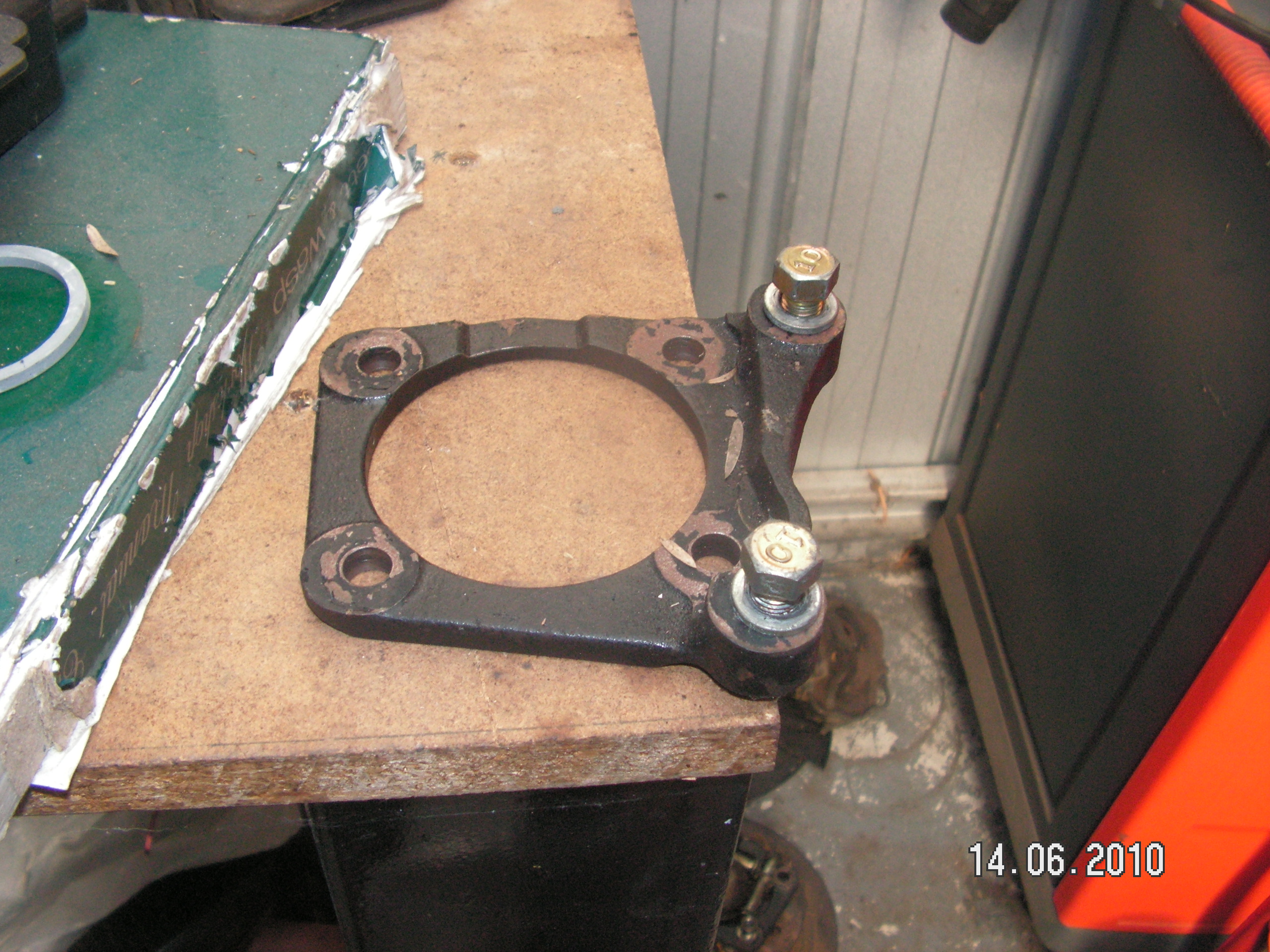

GT has a bracket that is mounted to the stub with 4 bolts. It would bee deemed to be the primary source of mounting. Therefore under Australian modification rules the use of 3 bolts minimum apply. In the intereset of safety, I would discourage the use of a 2 bolt mounting particularly for any road use.
As per piccy
Peter

Time to chisel the 40 years of caked on dirt and grime off that piece. It looked cast as one piece. Looking at the auction, the Kaemeri kit with the MK63 caliper looses the dust shield also. One more reason that I think the aftermarket calipers with the 3 1/2 inch mounting bolt spacing is a better choice.
Wed Jun 30, 2010 4:36 pm
Posts: 543
I've been slowly working out the details in my mind on these two projects.
Ironically, the caliper mounting for the larger S130 rotors is going to be simpler. I wanted to use a larger body caliper that mounts easily, but the body won't clear the dust shield, and I do not want to put something together that requires cutting the car. So I opted for a smaller body that uses the same huge pad.
Good news, no bracket. Bad news, the caliper must be modified to move the mounting hole position, so the caliper is not an off-the-shelf item.
I need to have a set of rotor hats made to play with this one any more.
The smaller caliper to go onto the stock rotor is going to be more of a pain. It is going to require having the caliper in hand before designing the aluminum mounting bracket. The manufacturer's drawings lack a little accuracy. But because it requires a mounting bracket, and fits the stock reproduction rotor, it would be cheaper to go with the larger S130 rotor with the modified but bracketless caliper mentioned above.
