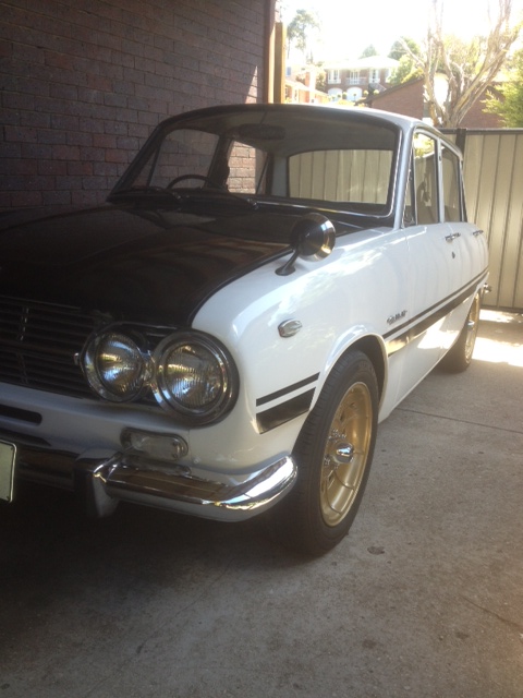

Hi
I am running a set of Advanti 15 x 7 with offset I think 38mm. 15 x 195 x 50 series low profile tyres
Require 'X' factor to clear calliper if running disc brakes.
Down side for mainlanders is I 'fine tune' with 5mm spacer on the rear
J

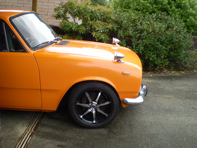

Thanks James. I would be interested in a picture of how the front sits in the guards ( front on ) as the +38 should narrow the track I would have thought. but I guess the extra width helps in this regard. As for the rear, by running a 5mm spacer ( which as you point out we can't do up here ), that would make it a +33 in effect. All of this is good news as it does make my search for wheels a little easier. Do you get any tyre rubbing on the rear at all ?
I am actually looking at a 7" wide wheel that can be between +25 and +44 offset, drilled and machined to suit, but I need to tell them what to machine it to.
As for your question Glenn, the X-Factor is theoretical figure of no distinct value. As James said it is a term used by the wheel manufacturers in reference to the contour of the spoke.
Thanks
Tue Mar 17, 2015 6:04 am
Posts: 428
Location: Sydney NSW
Your deductions are absolutely spot on
My front hubs have custom Volvo calipers and an effective machined spacing of approx 18mm out from standard so this would equate to approx offset of 20mm.
This is in keeping with Performance Supalites which are popular mags and run an offset of 18-24mm I think
Rear on Asroc 38-5mm=33mm but 15 inch is quite different to 14 inch mags in relation to clearance in rear guard
I am running 14 x 6.5 mags on rear of Bella with offset 18mm I think
So all said and done looks like 18-20mm +ve offset may be the magic figure for mags?
Best ask Toomanybelletts - Craig is the man in the know
J
Ps my 15's never scrub guards including full noise around Simmons Plains

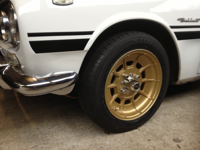

Here is the photo you requested from front
J
