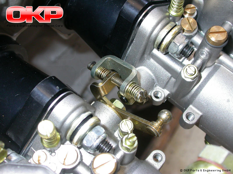

Can anyone put up a few photos of the webber type setup PR91 is talking about.
Fri Aug 26, 2016 12:29 am
With thanks to Google. I'm nowhere near mine ATM.
3 of mine use this. Easy to set up and doesn't ruin the carbs over time.
EBay has them. Look up "Weber throttle levers".
