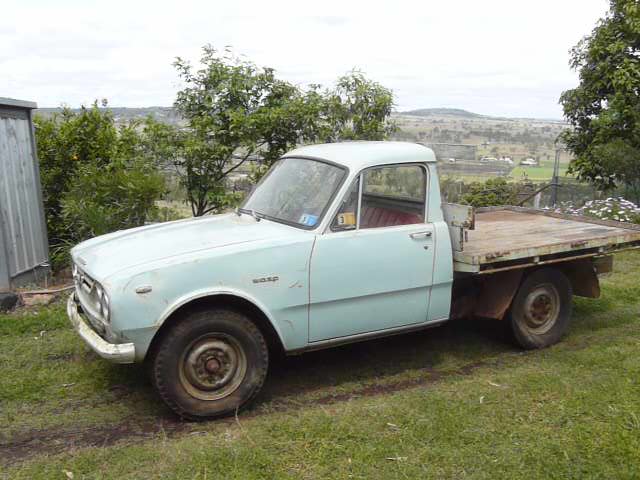

Hi my name is Matthew I am currently working on a 1965 Isuzu Wasp KR20 utillity, I am haveing a little trouble removing the head from the engine block. I have removed all the push rods and rocker arms as well as the 10 bolts holdeing the head down etc. It would be much appreciated if any one could share some noledge. I will put some pics on of the ute as soon as i work out how to. Thanks   1965 Wasp head removal

That is prity much what we had to do with this head.
File comment: The Wasp
File comment: 4th cylinder exaust valve is cracked
File comment: 4th cylinder exaust valve blown
File comment: the head at last

she looks pretty tidy. nice Ute.
keep those photos coming please...
Tue Sep 11, 2012 12:26 pm
Nice Wasp..........
Tue Sep 11, 2012 10:02 pm
Your Wasp looks pretty good, looking forward to many more future pics. :D
