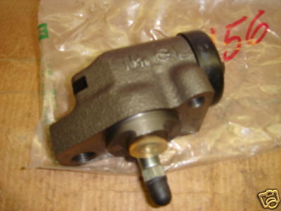

:oops: One of the wheel cylinders is bust, the housing is broken, visited a guy yesterday who owned/owns lots of Isuzus who told me he'd never seen this type on a Florian and sold me cylinders that should fit with some work... mechanic just told me no way, too big in all aspects. Anyone recognise these Akebono things, any tips maybe? They might be related to old Austin items apparently. Don't know the dimensions unfortunately... any help appreciated, this kind of thing comes with the rare old cars I like but it's demotivating as hell.

I do know the bellet rears can be replaced with older BMC wheel cylinders. They have to have the nut on the pipe changed. i would suggest you find a dealer that sells BMC stuff. there should be a few around. Also you may be able to pm IZU069. I he does not know no one will he has a great knowledge base as far as Isuzu is concerned, He has Florians.

Check theese out on eBay they're used in 72-75 Chevy Luvs drum brake fronts.
http://cgi.ebay.com/ebaymotors/72-75-CH ... 3a1318Q7c3

I'm afraid the Luv brake are quite different - probably because of the difference in lugs etc?

I should have looked better, sorry! It's the same thing, the angle confused me... bought one, now all I have to do is wait for it to turn up. Thanks guys for the quick responses!

No no no, it's all wrong... comparing the pics I should have seen it. Has anyone got any ideas? I'll try to contact IZU069 again...

What is the difference? are you aware there is a left and a righthand cylinder.

The big difference is the sort of trapezoidal piece that the originals have, the upper part on my pics. The others don't have that extra bit. I have now sourced a set of the right cylinders though!

Glad to hear you have sourced the correct parts, maybe you should consider a disc conversion in the future.

Hi JDMPlace wecome aboard, you should be able to get your rear wheel cylinders resleeved, we have them done with a stainless steel sleeve, should fix your problem
