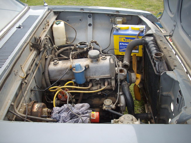

So I've made a start-
First, brakes wouldn't bleed. Master Cylinder was leaking back into the booster. It's in getting sleeved & kitted. The rest of the brakes seem fine.
Next, a grease. The grease nipples are still all fitted with their little plastic covers!
Then, Carby was a bit seepy. - Some of the screws were loose, so I replaced the spring-washers.
Drained water - Nice & green. Hooray, no corrosion! Flush-out. Also heater back-flush - still clean! Remove radiator - Back-flush. Very little gunge! :D Re-fit.
Drained the oil - :| pretty mucky - and the filter - lots if sludge. Being off the road for about 12 years will probably do that! Washed out the oilcap, separator & hoses. Yep, sludgy.
After I took the 'before' pic, lifted the Tappet Cover to adjust the rattly tappets. NOW I'm looking at sludge! Wash out Cover. Tomorrow I scrape up as much sludge as possible before filling with high-detergent oil for a flush-out.
You reckon I'm having fun? You betcha! :D

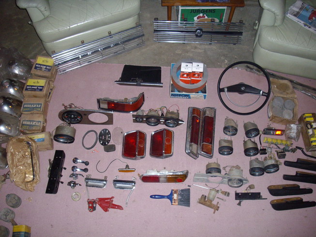

*Bonus* The whole deal came with a nice stash of parts. I just had to spread 'em out on the lounge floor. (Well, Tracy was away......)

whats in all the isuzu labelled boxes on the left?

Ah Mr Flibb, I somehow knew you were gonna ask that! Pretty random-
Boxes contain: 1 set of 4 Door Handles, 1 ignition switch panel, 1 Reversing Light, 1 'Florian' Badge, Headlight Globes, and 2 Speedos - Zero miles :!:
And did you notice those NOS headlight reflectors? I reckon Aunty Mary is in for a retina replacement. 'Bing' - Bright eyes! :shock:
And good condition early flat Grille & Headlights. Maybe I can build an early-girl around them?! :P

Today: De-sludged, cleaned plugs, adjusted tappets (Very rattley), new thermostat (160 F - 65 C), new oil & filter. Much fun! :D

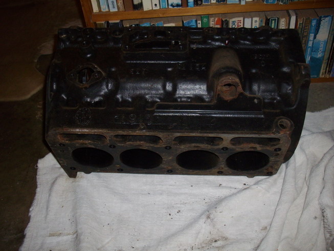

Forgot to mention this little bonus-

And this one-
Genuine replacement part: G161 Block, complete with main bearing caps & bolts :!:
Looks a bit ordinary in the pic, but that's just a little rust colour from storage. The bores are painted, and there's no engine number stamped in.
Nice bonus!

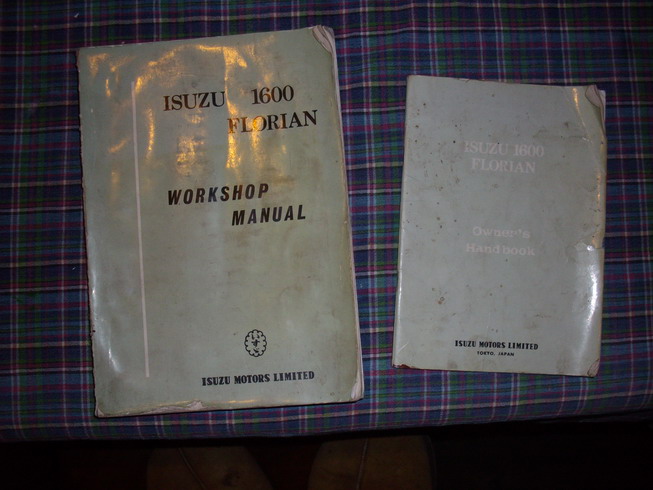

And a workshop manual! wow! officially i am now super envious!

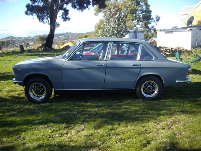

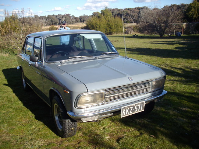

Not a lot of time today, but enough for a quick bath. It was time for some more photos.
After I took 'em, rubbed some polish on one back guard. Colour now matches the front one.
Gotta do the rest.

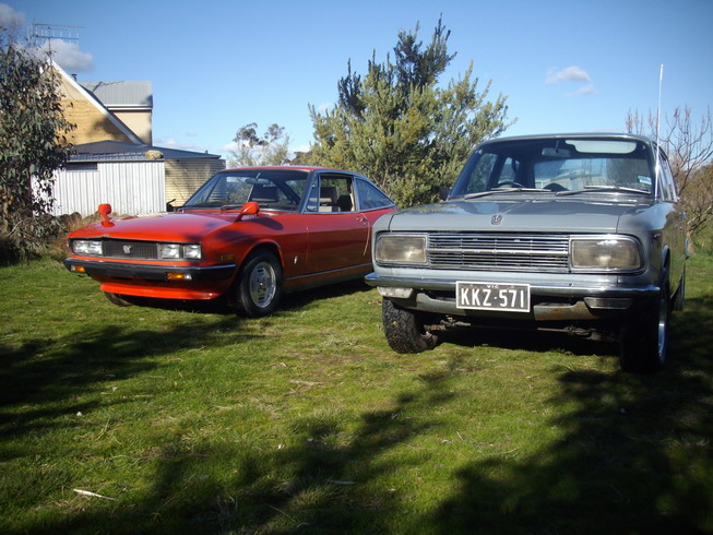

Of course there was a distraction today...........
A sexy.........red........distraction!
There's more about that in the 'Rumor Mill' thread.
Me enjoying? Maaaaaaaaaaaaayte!
Cheers (very), Matt.

Yep, pretty grinny! But I left out one detail. The 117 is actually Gary Carters. He dropped off my mail & he let me have a drive. :)
Looks like I'll have to make a 'My (His) Isuzu thread'.
Yeah, better not rat the KB for bits - might not get any more choice drives!
