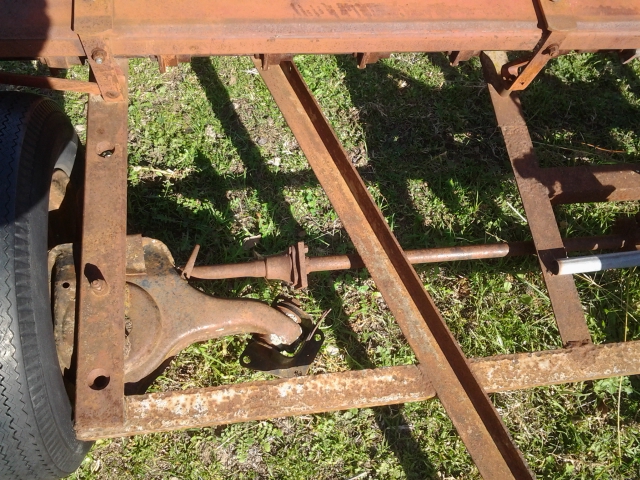

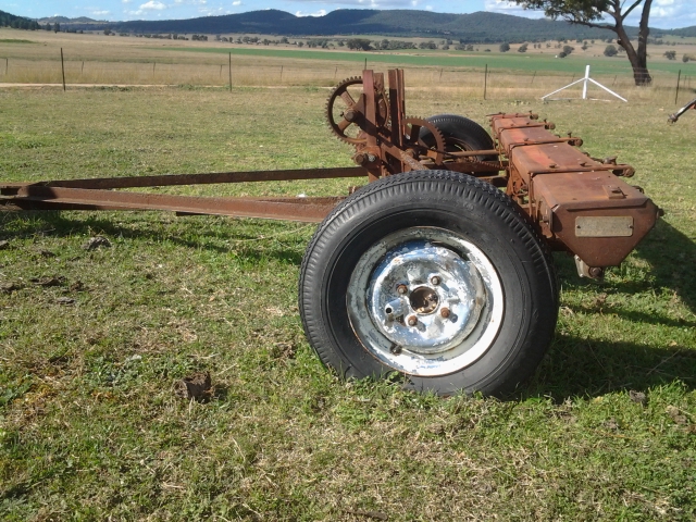

Massey Ferguson small seeder with Bellett wheels.....
and swing arms and driveshaft.....that drives! A gear set up dispenses seed and propells the contraption. A stationary motor takes the place of PTO and tractor to drag it. :idea:

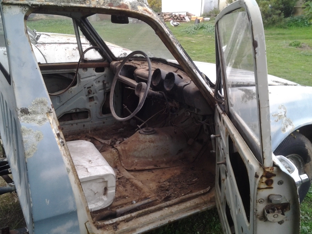

Upholstery a bit spartan, seat a bit basic....
But I've got two words for you,...........long.......wheelbase!!

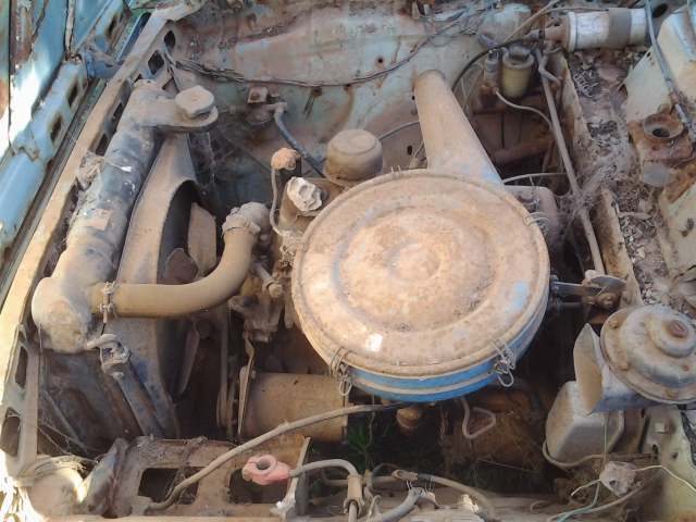

So I had an hour, hmmm..........
Lets open the Bonnet....
Seems Wasps are attracted to Wasps. So many mud nests, and the seller was busting them off as we chatted!

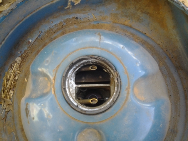

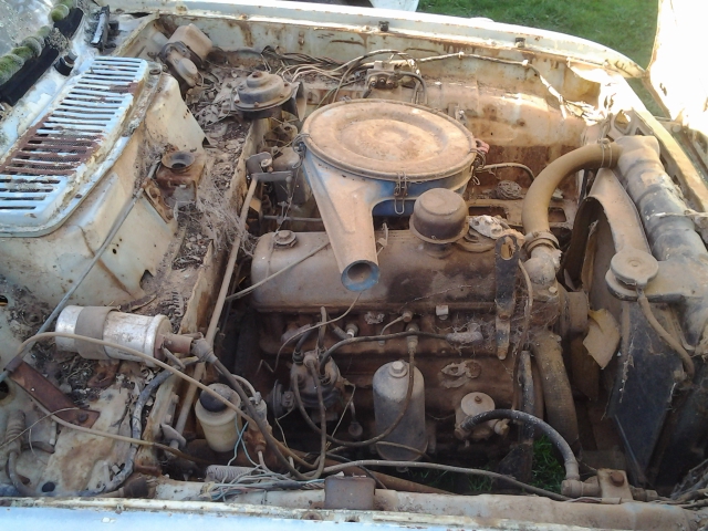

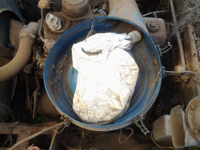

The engine number is different to original, so theres been a later 3 bearing motor fitted. Still has DC generator and reg fitted. And late aircleaner - is there an element to keep the Mudwasps out of the carbie?
of sorts :|
but its done the job!
Hmmm, grab fan, motor turns. This is good.
Remove KLG plugs, squirt in WD40, take crank handle & wind over & over. Now test compression with thumb - all 4 good! Try starter - just a groan :( Put in better plugs, try starter again - works! :)
Hmm, no spark, but power to coil ok. Put in new points. Now sparky! :D
OK, Aerostart. Spray, turn key, pop-pop-pop......
Fill carbie bowl with fuel, turn key........
HE LIVES!!! Started, ran, idled, no knocks, no rattles, no smoke........HOW GOOD IS THIS????

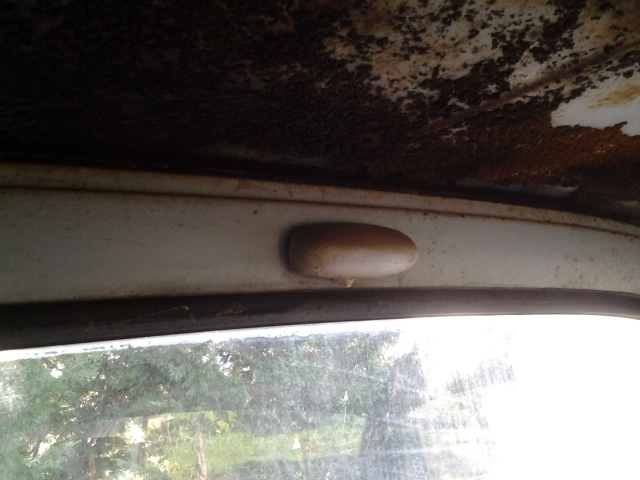

I forgot a detail -
Cab light still intact and working! Incongruity!

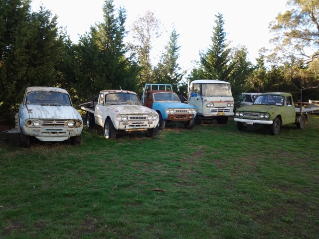

So I'm looking back over old threads, and this one is not up to date. I must fix this.
I know this more recent addition to the shot is a little....spartan, but its a Wasp, and restorable if a bloke is keen. I have found most of the bits, just short window frames and a seat.
Anyway, I like the pic. But theres still no styleside!!

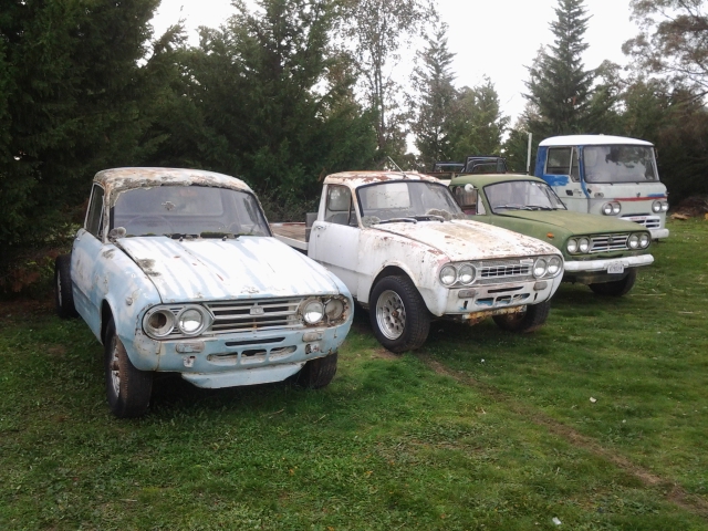

So you have FOUR Wasps?
The LWB Wasp you have; is that a different one to Gary's?
Wed Feb 10, 2016 10:46 am
Yeah Dave, now we have one each. My Wasp counts is now one more than Garys!
:mrgreen:
