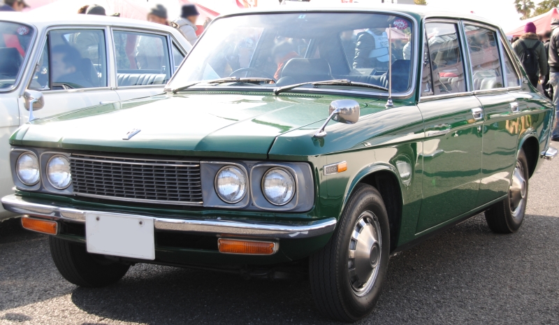

Hey Orph the 72 Florian has basically the Chev Luv front (will up load a pic)
Now that with the Chev badge and power plant would be Awsome :twisted:

Ha They Chromed the Luv bumper bar :lol:
Reckon that Flo front would bolt straight in with all existing Luv panels!! :o
