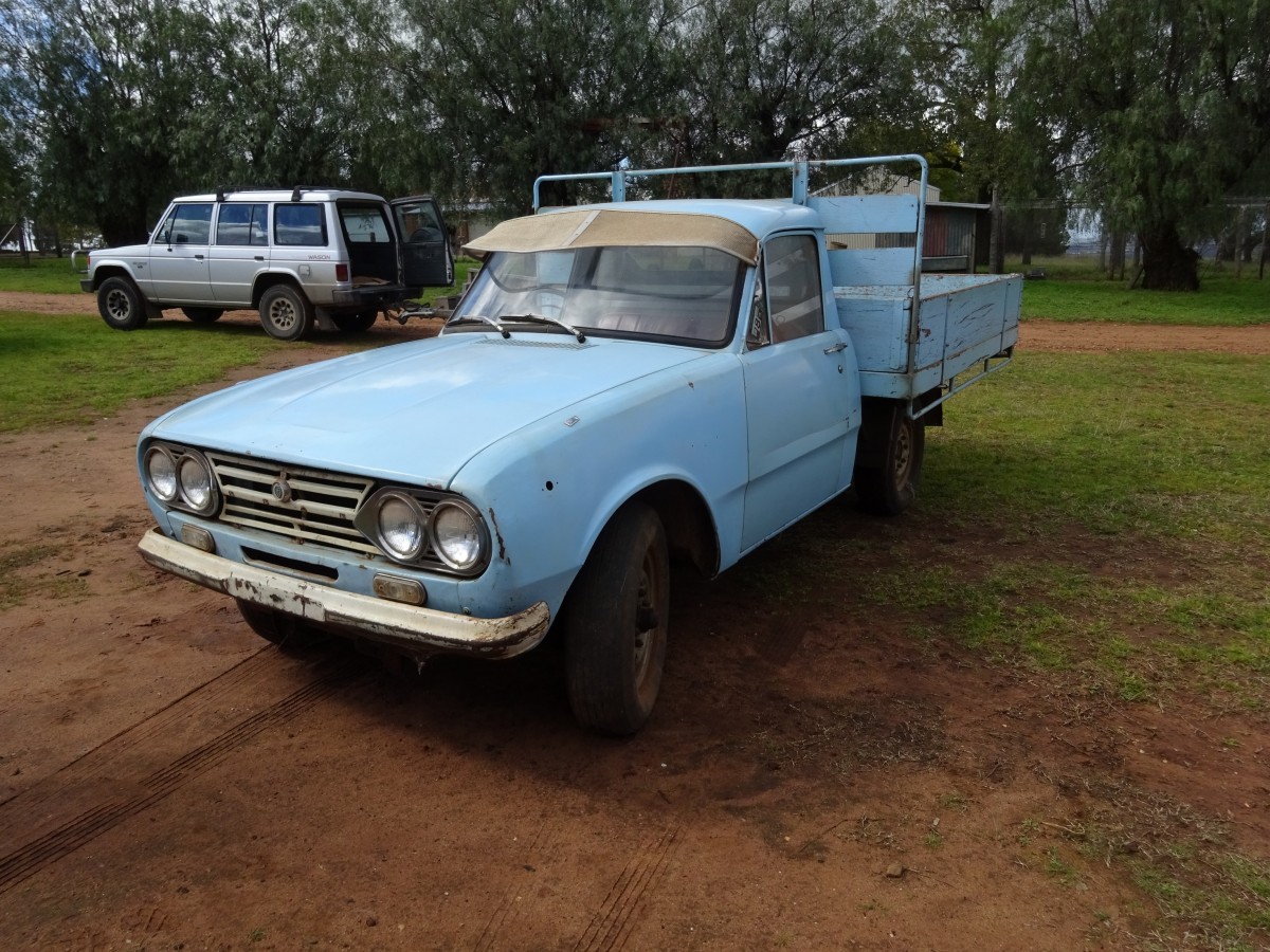

My Dubbo Wasp

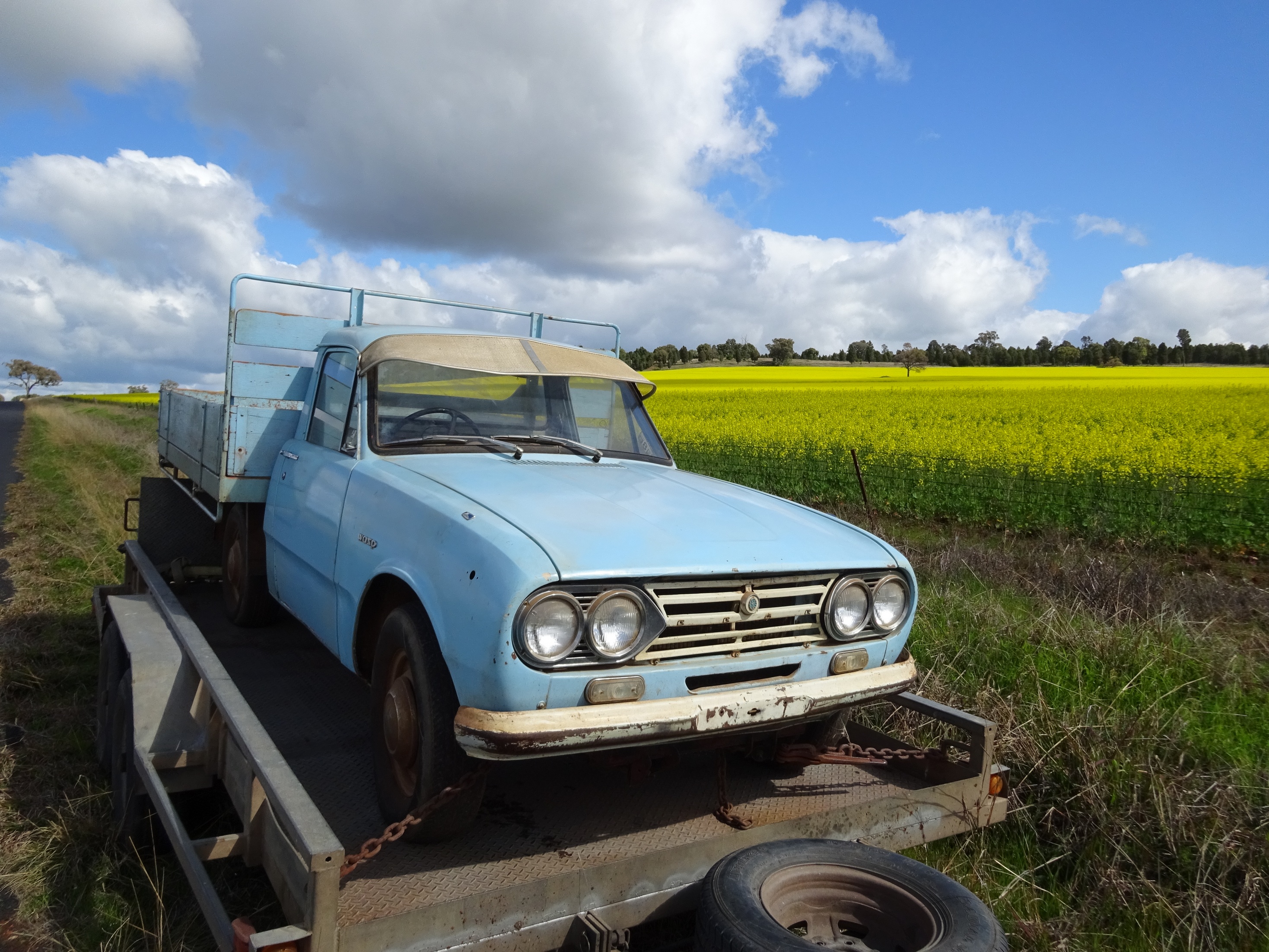

This ones for you Matty :)

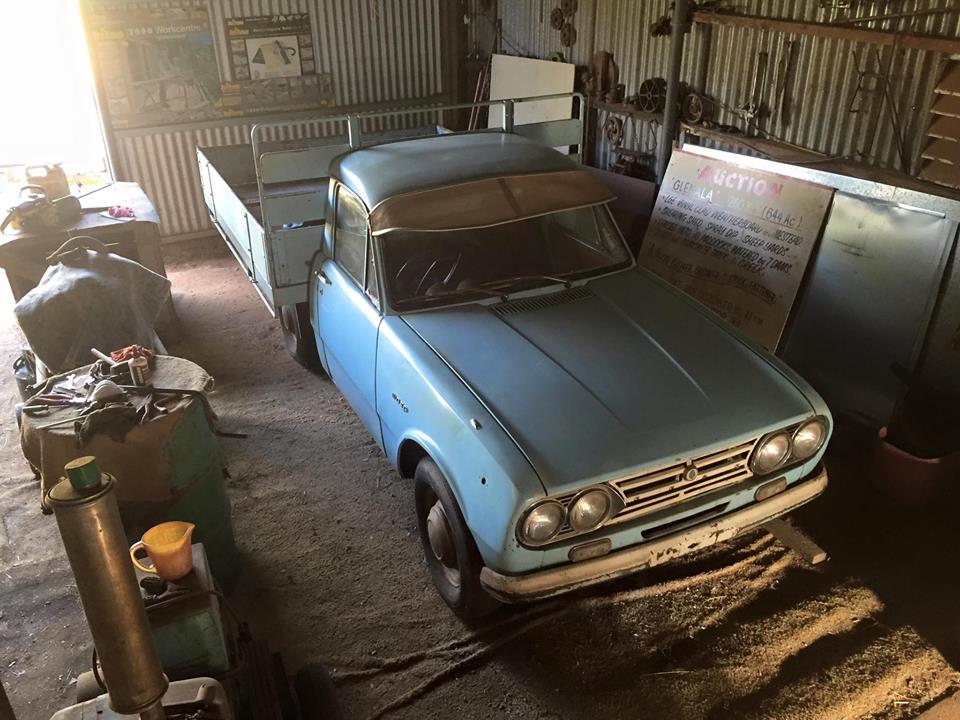

The Facebook picture that made me fall in love with a 1 owner, baby blue ute from Dubbo.........
Fri Mar 03, 2017 12:20 pm

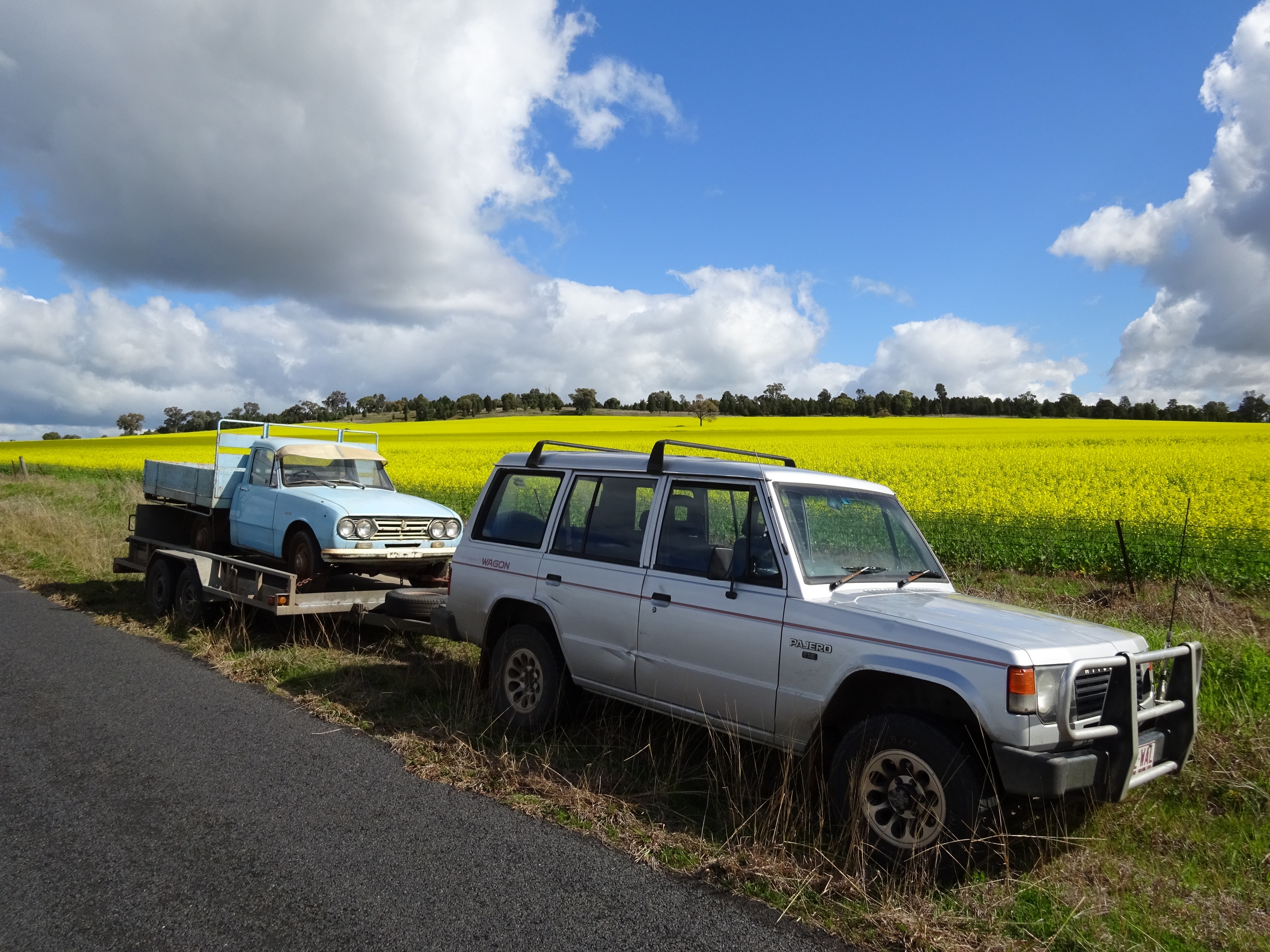

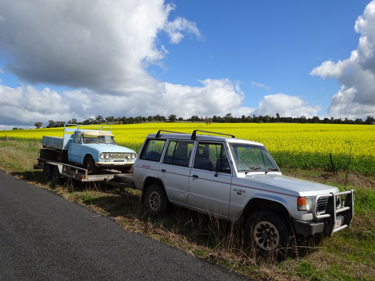

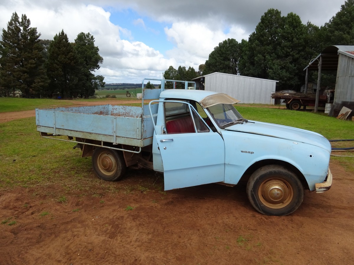

Some pics from the day I picked it up and the road trip home..... back roads style :mrgreen:

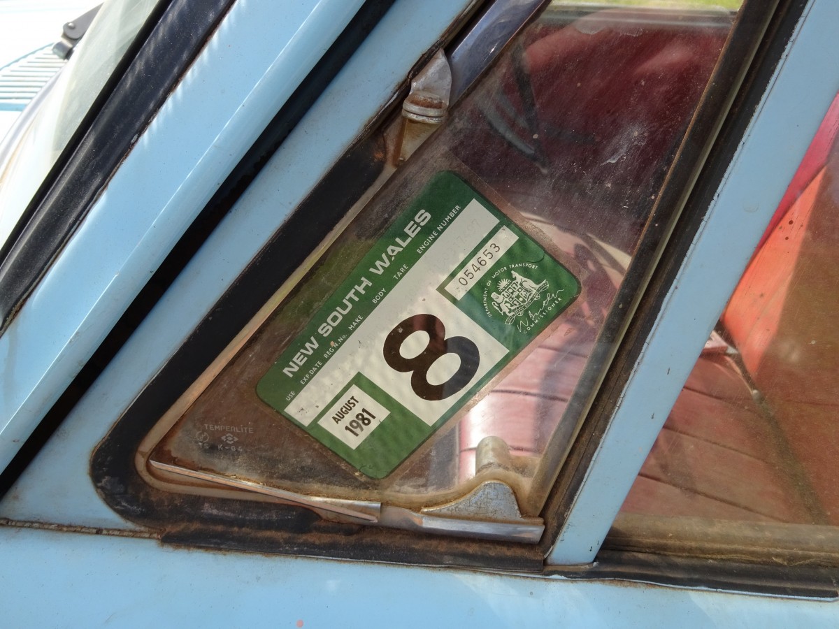

Last time it was rego'd was 1981 and the sticker is still on the quarter window :P

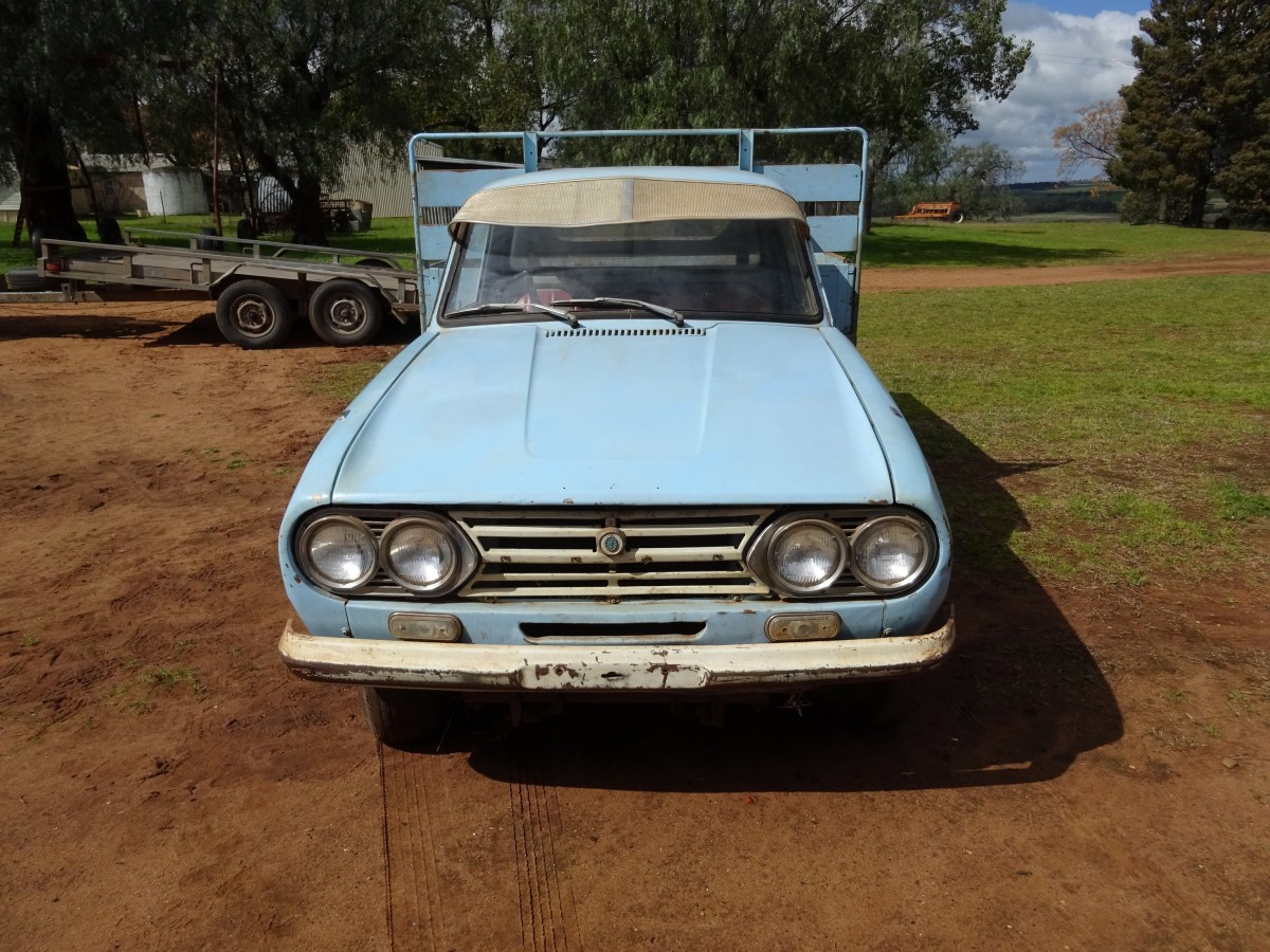

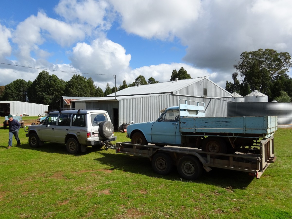

Loaded up and ready for the journey north to live with Donkey

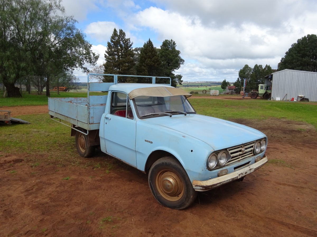

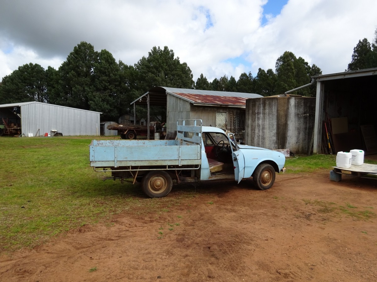

I drove for about 10 miles before I had to stop and take some more pics of my new baby..... best 5k I've ever spent :D

:shock: Wow! And look at the seat! So original, what a great find mate. Just need a couple of guard blinkers and rego time. Mate he is so nice, can't wait to see him at Mudgee. Possibly?
Enjoy the little tidy up mate, you deserve a relatively easy one. He is in good hands.
:D Matt.

He has his guard blinkers, tail lights and front bashpan panel inside the cab plus a few other non essencials ;)
The only things he is missing is a piece of trim on centre of grill, 1 hubcap (has 1 painted and 2 "use to be" chrome ones) and the top metal trim on the drivers door (I have plenty of those) + one badge is broken in half.
Other wise it's complete
I haven't even cleaned it yet as I want it's first showing to be as close to farm fresh as possible.
Mudgee is definitely on the cards for this little ute.

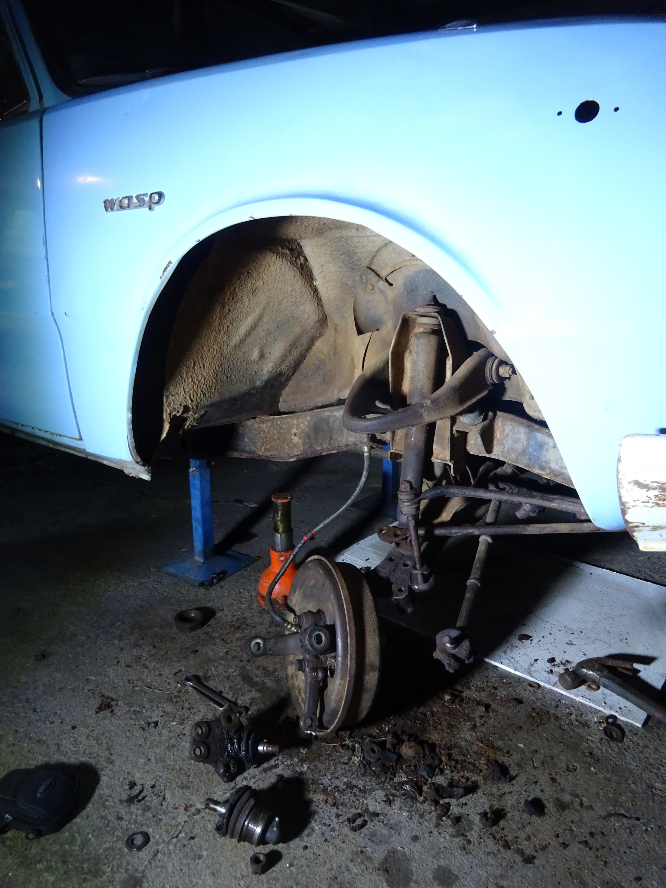

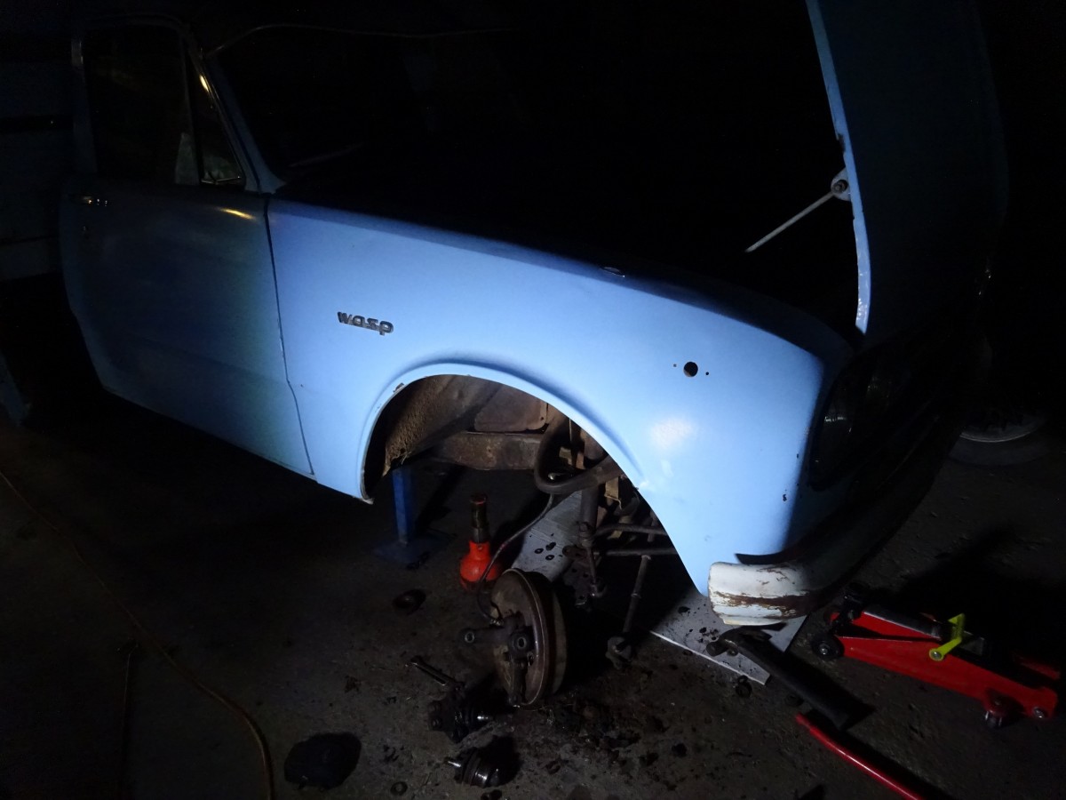

Today I started the process of changing the Dubbo Wasp's upper and lower ball joints.......
Jeez Louise!! 52 years of hard farm labor sure does make life difficult, 3 hours later and first lower ball joint still isn't out :| First bolt was a bit of an effort but second bolt came out sweet as a nut, last two are locked tight. Packed in with a lifetime of dust, rust, grease and stubborn hard yakka attitude :oops:
Plan B: I got one of them loose with a bit of help of a bottle torch and a can of WD40 but it still hasn't pulled completely out yet.....
The last one may require Plan C - A couple of beers and a few Bacardi and cokes to loosen ME up a bit before I go hostile on it's ass :x
......and that's just the first one :|
It seems that every component in the front end is original and flogged out, except the brake line on drivers side which has been replaced at some stage.

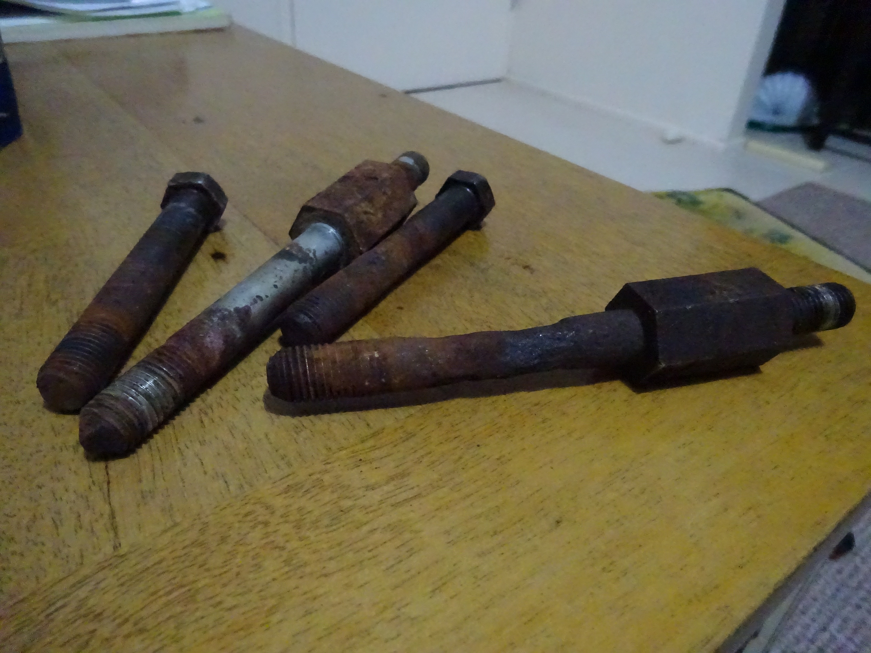

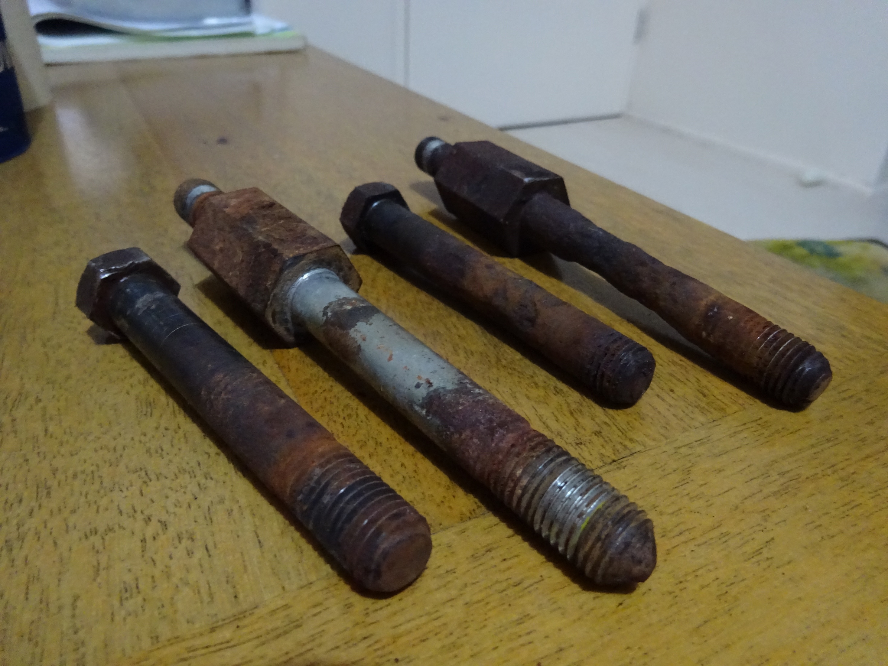

I took 4 1/2hrs to get the drivers side lower ball joint out :shock:
Never in my life have I had one that tenacious.
Two of the bolts were we and truly rusted in tight but persistence, a bottle torch, pinch bar, hammer and a few beers eventually paid off.
Does anyone know if bolts like these are still available off the shelf somewhere??
If not I'll get a mate to machine me some up

Progress on changing the ball joints has been painfully slow.
I couldn't do anything in last weeks deluge as I had a few inches of water through the garage.
This however pales in comparison and seems quite pathetic when compared to the Glen and Elaine Potter who had 14 foot of water through there place at Murwillumbah :shock:
I did finally get all the ball joints out but finding replacement bolts has been proving difficult.
A mate of mine will be machining me up some new ones but it will be a few weeks before he can slot it in so things have ground to a halt again :|
The lack of lighting under the house makes it frustrating too as I have to work with lead lights even in the middle of the day.
These couple of pics were taken at about 2pm on an overcast day but sunny days aren't much better
