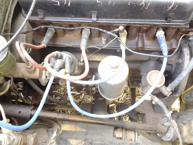

Yeah, it can be a nit of a mystery. Any if the other things mentioned are possible. I have had the little insulator block have a hairline crack that allows an intermittent short. Once Doris started missing with no explanation after sitting for a while. At least it was while we were at home. After checking many things I put an ohm meter onto each end of one of the little leads in the dizzy. As I wiggled it round, the needle bounced all over the place. The wire had broken down with age.
Here is Shrek's dizzy, and he goes really well.
It is my only early dizzy equipped motor, all the others have the late long point one.
:) Matt.
Sun Sep 17, 2017 11:34 am
Hey slacko, the wiring is not in the hooks! Probably should fix that!
:D Matt.
