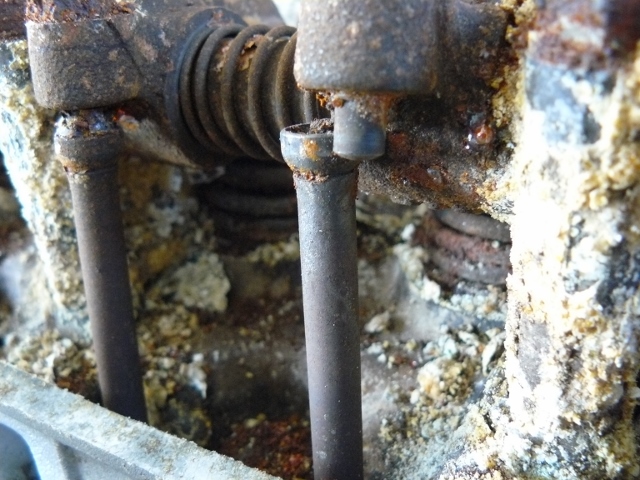

I was with you oz Lizzies race car got a quirt and sat for a few days and never missed a beat. This one is a little too far gone. The engine bay got a degrease and some truck wash. I also found a push rod dislodged on number 3 when the owner recalls it having a miss. I have a gt block here that needs a look at but it might be the go :?: If the car was not in such good nick I would have to look at a s/b chev or supercharged commo but it is not the right car for that treatment.

but that engine block could be bad enough for a rebore etc etc rust damage.

Thanks farmer time will tell as far as the engine the sump had a mix of oil and water so we have to wait for the report on the head. The block was out of ol yella and has also seized from siting. At his stage we wait. Are late sedan and flo heads the same I assume yes but confirmation would be good.

the muck all over the head looks very similar to the engine i pulled out of the florian i wrecked, it all cleaned off reasonably easy but left some damaging pitting on the pushrods!

The florian head was saved but the rocker gear was frozen in place but was destroyed when the guys eventually removed it. I sent rocker gear from a g150 a little different but should work. The block from flori is still soaking and still a solid boat anchor. A gt block now with Gemini pistons and rods with the florian head will be the powerhouse. It will look right from the outside not that it is hotted up either[a gt camshaft might turn it into a tyre fryer :lol: ] I got a gasket kit from dick so I cant see any hold ups as I now have a manifold gasket. While he has sat I cleaned the fuel tank out ect so i think when the engine goes in a new exhaust we can move on to find the rear end problem at this stage no clues. No bath for Flori i reakon his first show should be as he sits cocky pooop and all 8-) . I threaten to take him to carnival but running out of time.

Flori pulled out of the shed yesterday afternoon under it's own steam since 1988. To get it to this stage was a challenge. As photo's show the engine was not healthy and was soaked for weeks and remain a lump of rusty steel.[bound for china soon]. As stated I had ol yella's g161 block in storage and Flori needed to stay as original as possible. I can say this was not as simple as first thought the head was sent for reco and was saved this was the first concern it was then the rocker gear needed to be forced off and was broken in the process. Bellett rocker gear is different but was modified to suit. Once the head was saved the block was sent for a bore and a new set of rods and bearings the crank had a grind ect this engine has been sitting since 1990 when ol yella returned home to his rightful owner :lol: . This is when the fun started a good day with a full gasket set we can bolt this thing together :oops: once the block was in one piece we came to a halt as the sump did not clear the oil pick up this is ok we were to swap the pick up. bellett pick up was different so now we need the florian oil pump would be the next option that is still seized in the block this took a few hours to remove as it was seized as well as the cam shaft. The oil pump was soaked over night but never revived. A new bellett pickup was redesigned. A florian sump is recessed at the rear for the drag link so a sump swap was not a option. A rebuilt kit was bought from Holland for a the florian as I thought this would make life easy as I needed a manifold gasket anyway only to find that the dowels were at the top and the holes were located in the bottom of the gasket so new dowel holes were made then to find the stud holes were half a whole out on half the holes.[I think Isuzu had a full time head and manifold designer trying to justify his job :lol: ] These problems are only a few of a reasonably simple rebuild.
