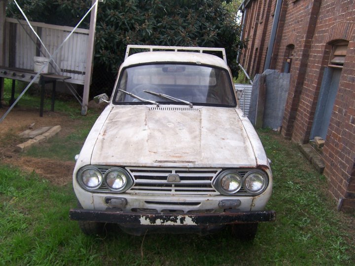

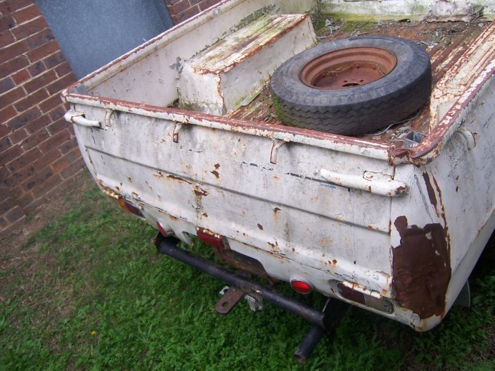

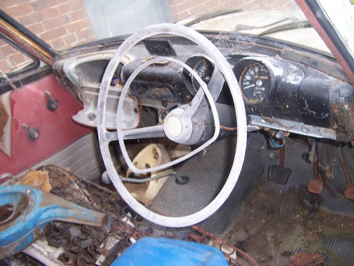

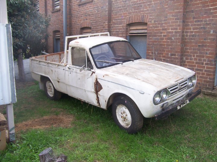

ok might as well give this a go! since i know bugger all about the wasp, and since the plate with all the details on it has evaded me, i thought i might leave it up to you guys to fill in the blanks!

Holy crap dude that is not overly worse than mine!
Not much that can be filled in though; the build date info etc was never printed on them.
Probably the best bet for you is to check out the Wasp brochures for the original specs.

koolies. i wasnt sure exactly what to do about the rh door, im assuming someone had left the door open and reversed into something quite hard! what do you reckon condition wise? i know it will be a mission either way, but it would be worth it though hey?

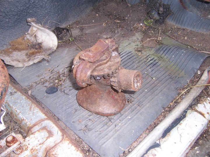

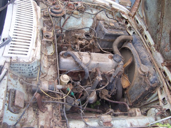

got the other pics working

Holy shit dude, that Wasp is about 75% as good as mine, and mine is running and registered (uh, except for a current head gasket issue!).

Oh yeah, I noticed that the rear reflectors appear to be the original ones, although someone has moved them to make the rear of your car look a bit cross-eyed! A look at some of the stuff above should reveal where they're supposed to be.

also i had a look earlier for any details about the engine, and the only thing i could find was G161 stamped on the block. does anyone know what that means?

Yeah man it looks like it's got an Isuzu Florian/Chevrolet LUV 1600cc engine, rather than the G150C 1500cc donk that would have come with it.
The 1600cc G161 from the Florian/LUV is a straight swap, but the Gemini G161Z doesn't bolt straight in; the Bellett runs the mounts way down the front of the engine, while the Gemini runs them about half way along the motor.
I've seen pics of it done, but the Isuzu G180 and G200 DOHC motor fits in stacks easier as the mounts are in the right place, normally.

Just looking at your pics again, I'd go so far as to say that yours has LESS rust in it than mine!
Plus they often rust in the roof.... which is a fairly big job to sort out, however yours appears to have not, which is good.

yeah well considering it had been in a paddock with one door wide open for over 10 years, its in reasonable condition. the interior suffered a fair beating from the weather though. i looked at another g161 on google, and the numbers are in a different place to the ones on the wasp. dont know if that means they are different era maybe? also how would i go about getting seats? as mine are just springs at the moment =)

Hey "Waspy", Thanks for showing us your fantastic find - one of 7 stylesides I know of. Amazing how much a good cleanup helps. If your seat springs are not broken, I reckon the best thing is to re-upholster the original bench - gives you the max legroom. About $400 where I live. Try getting the motor going. I recently got one started that had been sitting for fully 30 years! (See 'Barn Find' in My Bellett section) Put some penno down the plug holes, leave for a couple of days then wind over. If you have compression enough to push your thumb off the plug holes, it will probably go. Put some cheap clean oil in the sump before starting. Maybe you'll get a nice surprise!

well hopefully i will get a few spare hours this weekend, would like to do a proper cleanup on it. thats about all i can do with it at the moment with my financial status. the only problem with getting it started is the fact that the owner before me had pulled a heap of wires out from under the dash after parking it. i guess it will be mostly trial and error. they were a fairly basic wiring system back then, so might just need to spend a bit of time with my head under the dash. i am fairly sure the springs are all in fairly good nick, just pretty rusty. i have a good mate of mine that could probably bang something up for me. one other critical fact that i hadnt taken notice of until we got it home: there is no ignition key. but to my surprise one of my spare keys from my KE35 corolla coupe fits straight in and turns! would like to get a proper wasp key for it though. i heard that you can take the barrel to a locksmith and they can make keys from using the barrel?

Well Kemosabe, perhaps I can help. I have a Wasp wiring diagram, but my vintage scanner is having trouble getting a clear scan. I will try again tomorrow. Maybe the trick is to photocopy it & mail it to you.
You have discovered the fact that, with age, most Bellett / Wasp keys fit most Belletts! I have a tin of old keys that don't fit my locks. I could send you a couple. PM me your address if you like.
For a shortcut, you can run a live wire to the + side of the coil (& ensure the - is continuous to the dizzy), then push the button on the back of the starter switch to wind it over. (left inner guard)

time for an update! i have 2 weeks off as of today, so i will be spending as much time as i can doing what i can to get the wasp running. spent a bit of time on her this arvy. got the seats and moulded floor mat out, had to sweep the floor pans as they were covered in what was left of the seat foam, and about half a ton of 10+ year old cow shit and dirt. surprisingly enough not as much rust as i though. big pain in the ass, i will have to pull the fuel tank out, since someone flogged the fuel cap, and no doubt the tank would be full of water. will keep you guys posted on the progress, and take some pics on the way!
