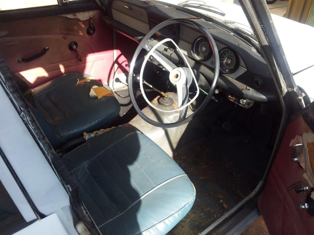

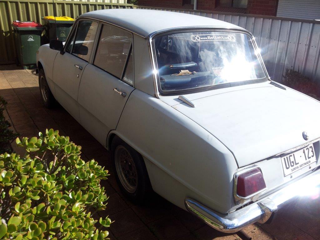

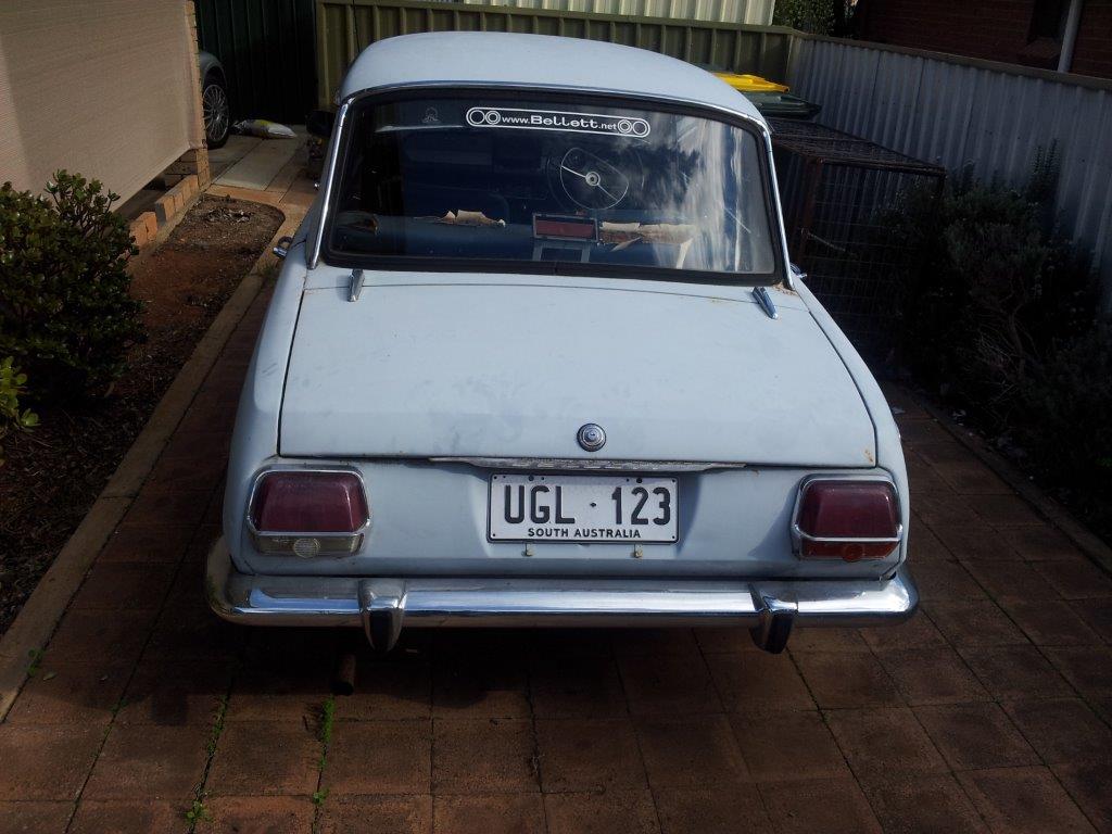

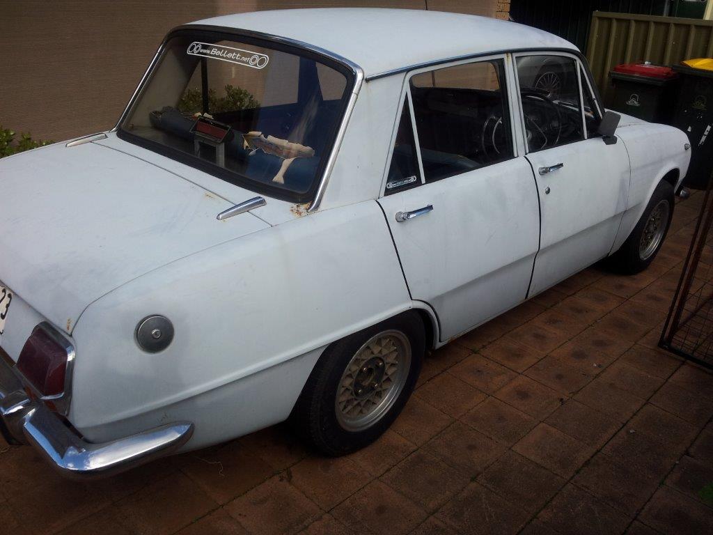

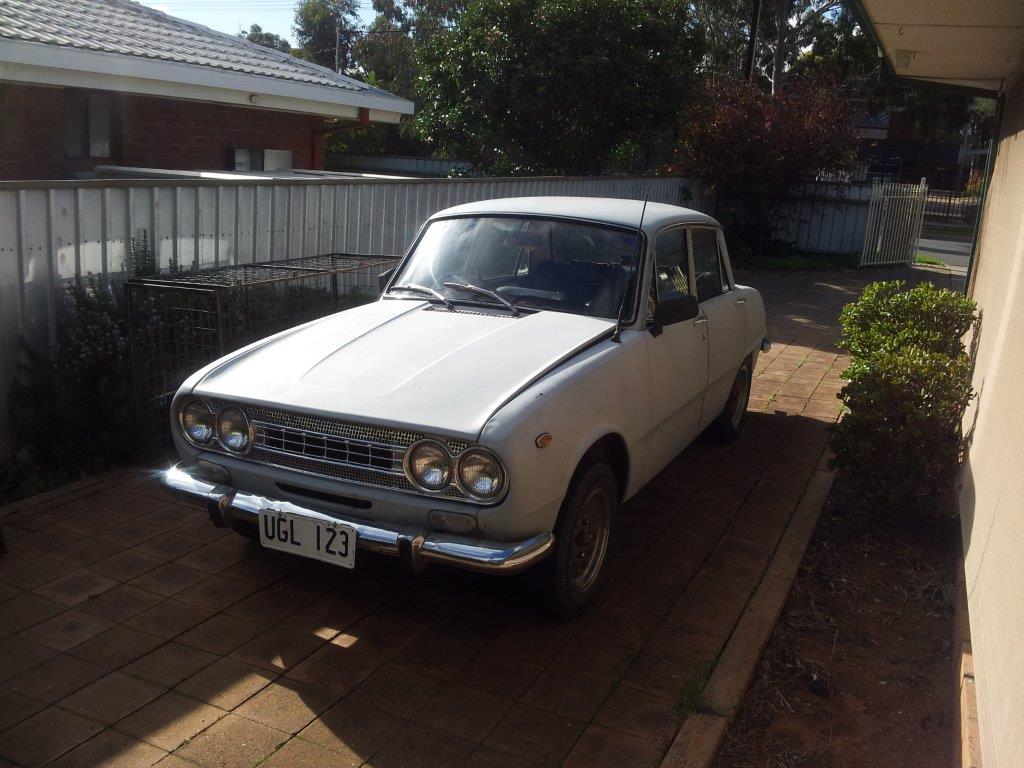

Hi,
I had been looking for a Bellett for my Dad as a project as he had a couple of them back in the day! My Dad has not been well and wanted to surprise him with the Bellett to cheer him up.
I was fortunate to get a call from Chris (oz_toffa) about one he had for sale and after a few months I am now the new owner. I would like to thank Chris for the effort he went to with the sale.
Here are a few pics, I am planning on trying to get her ready for the nationals with my Dad and my Daughter so let the work begin.
I have no plans on colour as yet we will get her ready for the road with a tidy up while we organise the paint, interior and wheels.
Enjoy the pics.

Mon Jun 10, 2013 12:34 pm
CONGRATS on the new project.
Keep us all updated with pictures of the build please.
Love the number plate "UGLI"
cheers
Mon Jun 10, 2013 9:27 pm
congrats on getting the grey ghost! I have a few fond memories of this car, will be good to see what you do with it as you go!
Welcome to the madness!
Mon Jun 10, 2013 9:47 pm
Me thinks Oz will retain those plates!
Good to see he's already Bellett.net-stickered it up for you!

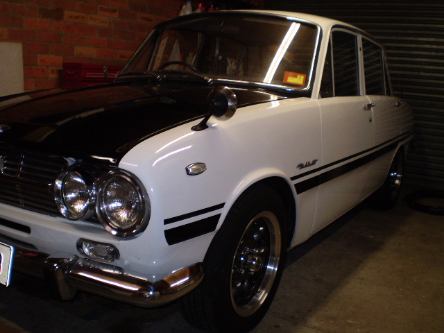

Hi Jeff
I have a brand spanking set of Charcoal Supalites - 14x6 with brand new Pirelli tyres 186x60x14
As per picture I took them off to fit some Magnum Dominators
Problem would be postage - bit pricey
Either way let me know
J

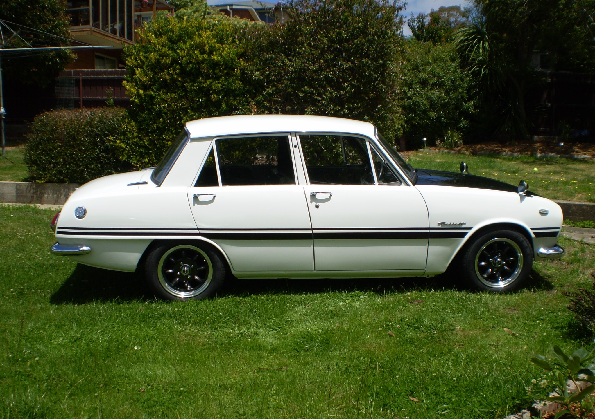

Fri Jan 30, 2015 1:16 am
be cool to see the grey ghost out, i dont care what wheels its on!
