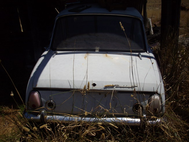

:o You never know what's just around the corner. A Street Machine builrer mate found this beauty a while back while treasure hunting abandoned farms. He found himself a '42 Chev Maple Leaf and this for me.
1965 COLUMN BENCHY!!!!!!
File comment: NO Tower rust!!!

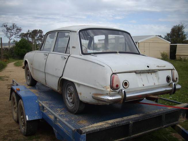

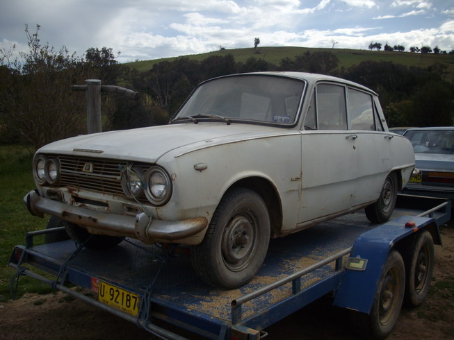

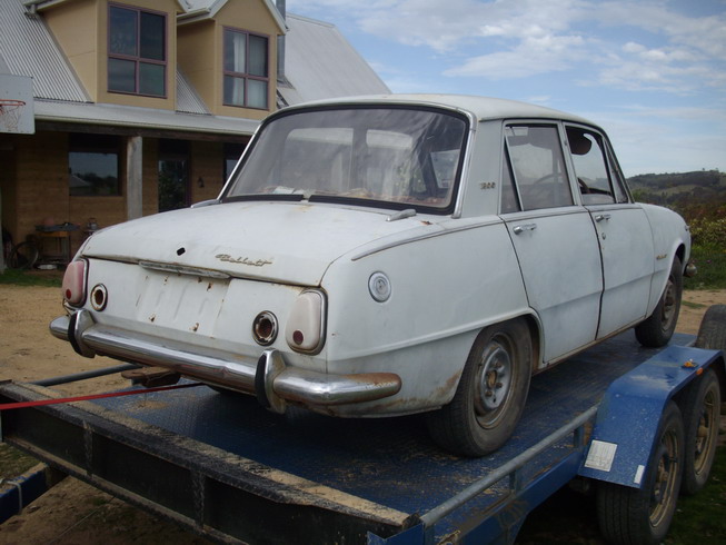

After tracking down the farm owner, my mate was told "Not for sale", but after a time,a buyer came along for the property, so he changed his mind. My mate got the truck and I left for the nationals not knowing if the property deal would be done before I got home.
It wasn't :D so a rescue plan ensued...........

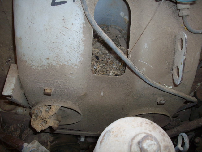

Yeah Ross, I think it's better than it looks. Under all that chalk is mostly sound paint. (I compounded a bit) We scratched around the shed & found everything bar 4 wheelnuts, the crankhandle,toolkit , jack & distributor.
First step is to check the motor condition. If it's a goer, the rest might be a fairly easy job.
Story is, the car has been in that shed 30 years. An old timer local said "I remember that car when it was new. Margaret bought it when she was in her 20's" Now she is in her 60's & lives about 45 km away. So it's kinda a 1 owner! Speedo says 85000 miles. Given it was only driven for 14 years, it's probably genuine. Shift mechanism is tight & positive, & the steering has no play.
It looks to have killed Skippy at some stage, so will need another skirt & radiator (which I have).
(Radiator is stuffed full of Plasti-bond!!)

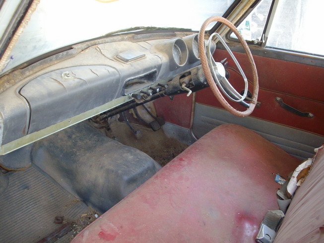

Door trims are good, so only the back seatrest & whole front seat need repair. Under the mats (& all that rat poo) is clean paint - No rust!
Worst bit is below the battery box - a disintergrating battery has caused rust that will need plating.
So I'm keen.......

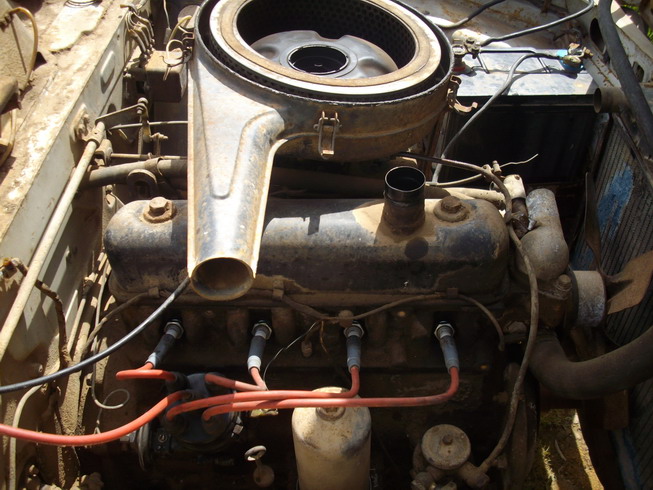

Had a little play with the motor today - Put in a dizzy, stuck a coil on, cleaned out the oil filter & filled the sump, stuck the hose in a radiator hose and dropped the fuel hose in a jar of petrol.
SHE LIVES!!!! :o WOO HOOOOO!!!! :D
O.K. -hard to show life without video, but look - No 'chimney effect.
Breather pipe - breathing, not smoking!!!

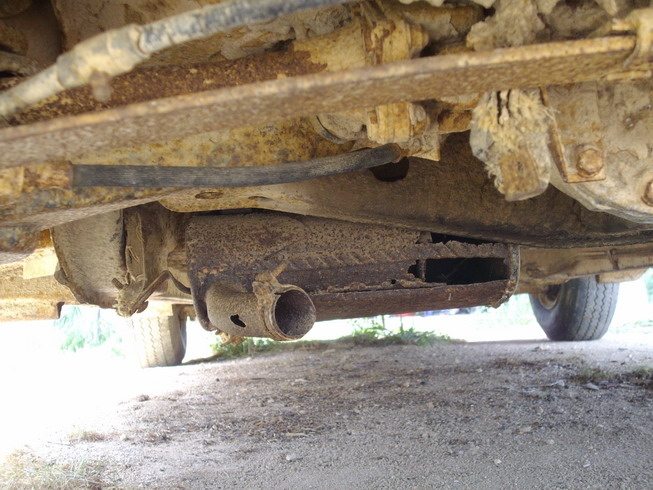

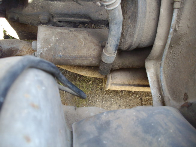

Exhaust about 2 mins. after turning the key - smoke free zone!
Note - original type muffler! Bit of a time capsule!

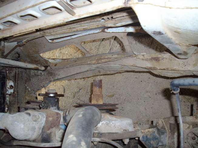

Had a spare hour, so I checked the fuel tank - Dry. Rinsed it out - no rust! :o Removed the mudwasp plug from the cut-off fuel line & blew back to the tank - clear! Put a filter in-line & some fuel in the tank. Turn key - start - run - idle - sweet! Hmm, Brakes? Pedal was stuck hard when I got it, so a week ago I put some fluid in. Pedal freed up, so I got Rhys to help me bleed em out. Now got pedal! Surely they wont work - It's been 30 years!! Start motor again, back out of carport - apply brake. Progress slows! Drive down driveway - apply brakes. Progress slows pretty well! VERY EXCITEMENT :!: Drive back up driveway - 1st gear - 2nd gear - 3rd gear - no more driveway - apply brakes - Almost skid in dirt!! VERY AMAZEMENT! :shock:
Now for the freaky bit.
This is the worst bit of the car - pummelled & rusted subframe below radiator -

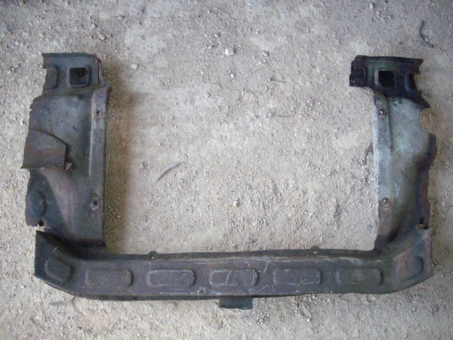

So I'm looking for something else a couple of days ago in the boot of a car that came to me full of spares (that I hadn't unpacked in a year!) I knew there was a diff & a diff centre & some other stuff. But what's that on the bottom, under the diffs?...........
Just exactly the piece I need for the repair!!!
:o :shock: :D Hows that work?? I guess some things are just meant to be!!!

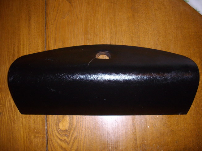

See, It's a good thing to give a mate a hand. Gary C. needed to clean out part of his shed ( it's a big shed). So we're moving boxes of stuff around and what do I notice in one of 'em? - '65 glovebox lid pad! "I didn't know I had that!" he said. Pretty good nic, too!
1 less bit to track down. :D
