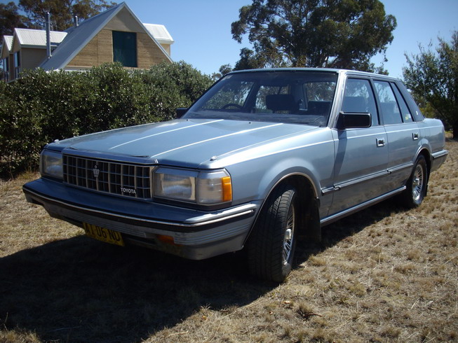

The sudden demise of my '85 Crown has brought a sense of urgency to getting this factory black '67 sedan mobile. I've got 3 weeks till school goes back & I don't have a shopping buggy.
Here is a 'before' photo of the Crown, but I don't have an 'after' till I go to visit it in the Pickles yard. Story is, I lent it to a mate and she got crossed-up in the dirt, went through a clump of wattles, a fence, over a bank & did a 270 deg. roll into a dry creek bed. :o Good news is neither her or her 2 kids were hurt, and, yes, I did have some insurance. Car is not so good - a bit outa shape. :cry:
So it might seem strange giving cars names, but it's easier than saying "the black one, the grey one, the bit darker grey one, the goldy-browny- rusty one" etc.

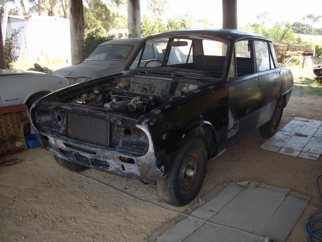

So "Black Betty" was brought down to me from Inverell with buckets full of spares by a nice bloke named Eric. He swapped me for some Austin A-105 parts Gary C had. (I did some fencing for him to pay for the parts).
As delivered-
I've made a start! will post more soon.

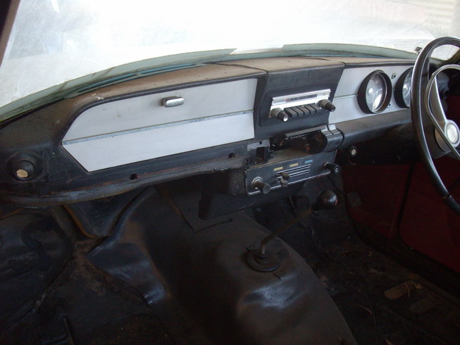

Dash not bad, just the 2 'normal' cracks.

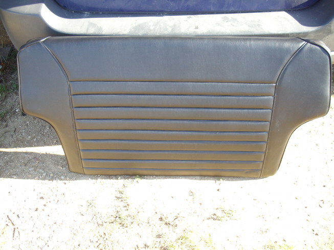

Rear seatback re-upholstered (it's black)

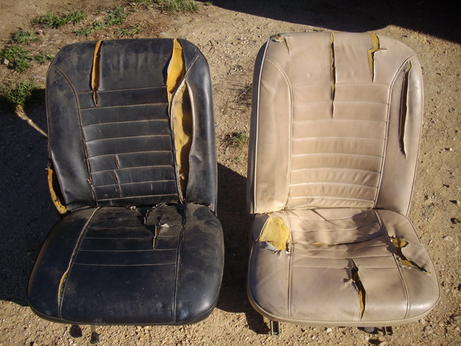

Now for the front ones...

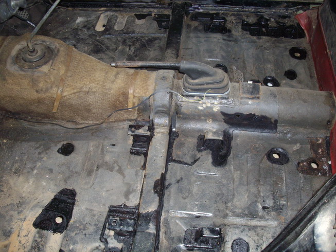

No holes! Just a few surface patches to convert.
Sun Jan 10, 2010 11:49 am
That rear seat looks very neat.
Was it reasonable price?
The picture of the floor is very helpful : )

geez that rear seat looks a cracker ....rob from sa obviously likes it also you dont stop do you regards dave keep up good work
Mon Jan 11, 2010 6:58 am
Yeah, the seat is pretty nice - $215 - O.K. I reckon.

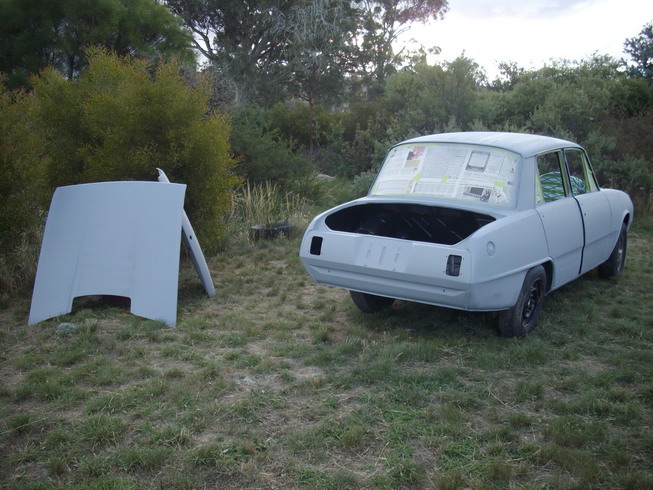

Took a few pics this morning of Betty getting naked -
Very more naked now. Zero rust around the windscreen. :D

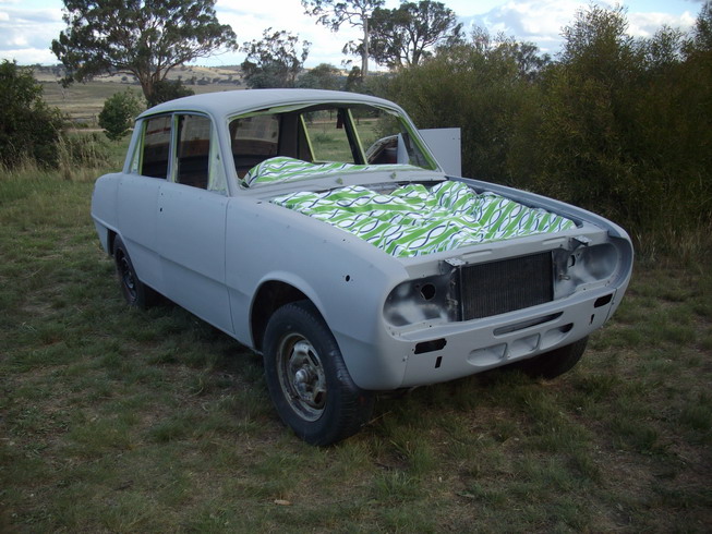

Betty is temporarily not black -
Cheers, Matt

Hmmm, try again with the pics.
