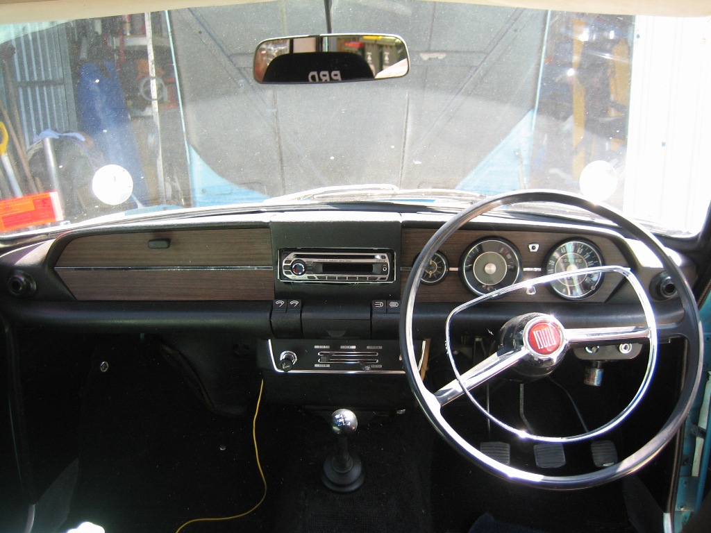

Hi guys,
Here's the dash photo that I promised from a previous post.
File comment: 1969 Deluxe dash photo
As you can see it has the older style wheel even though this is a 1969 model year deluxe. I recon that it has the '68 style spline which would make sense looking at AriNorjd's photo above. This has steering lock but the ignition is still on the dash like the older model.
Does anyone know what steering adaptor will fit the older hub? I've got a sports wheel here but I can't fit it as I don't have a boss kit to suite!

I think from memory the early is the same as a Mazda hub.
Mon Oct 13, 2008 5:11 am
Thanks Bellett65. Do you know which model? Early stuff or later? I have an '88 RX7 here I might swap that one over and give it a shot on the Bellett :)
Ross
Mon Oct 13, 2008 6:43 am
I have a Holden Commodore VP Boss to fit my sports steering wheel to my Bellett (1966/7)
I went to the local Autobarn (in Darwin) to find a Boss for it about 10 years ago - the guy behind the counter was not interested in letting me measure some of the boss adapters, because it was too hard for him (I did ask nicely) when that didn't work I asked "So you won't let me find one that fits my car so I can spend my money here" and he said "Nup". - I have never set foot back in Autobarn since. More fool him.
I went home pulled the sports wheel off my commodore to get a rough size and would you believe it - it slid on straight and true and has been there ever since.
Mon Oct 13, 2008 9:45 pm
Cheers redback, I'll give that a shot :)
Tue Oct 14, 2008 1:09 am
bellett65 is right.
early column splines are the same as RX4 and series I & II RX7.
the RX4 one is longer than the RX7, so the wheel is closer to you with an RX4 boss.
the wasp is the same as the early column. i have an RX7 one in my wasp.
late column splines are the same as TE gemini.
my race car has a late column in it. i put it in coz i already had the wheel for it that suited a TE.
Wed Oct 15, 2008 8:26 am
That would explain why the Freegard Wasp here in Adelaide has a bugeye Mazda 323/Series 1 RX7 steering wheel on it... (with the 'Mazda' scratched off).
Thu Oct 16, 2008 5:57 am

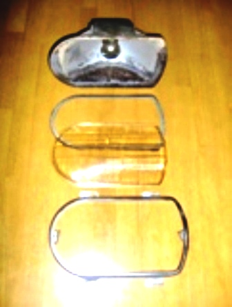

Square type headlight assembly for the pr10
Mark

BELLETTPR10,
Nice Pics on the breakdown of the "single headlamp" version. Of all the searches I have done on different flavour Bellets, the single headlight variety appears to be a rarity.
Oh yes, in answer to your question, Yes, this thread DID get sidetracked. This happens when people dont pay attention to detail.
