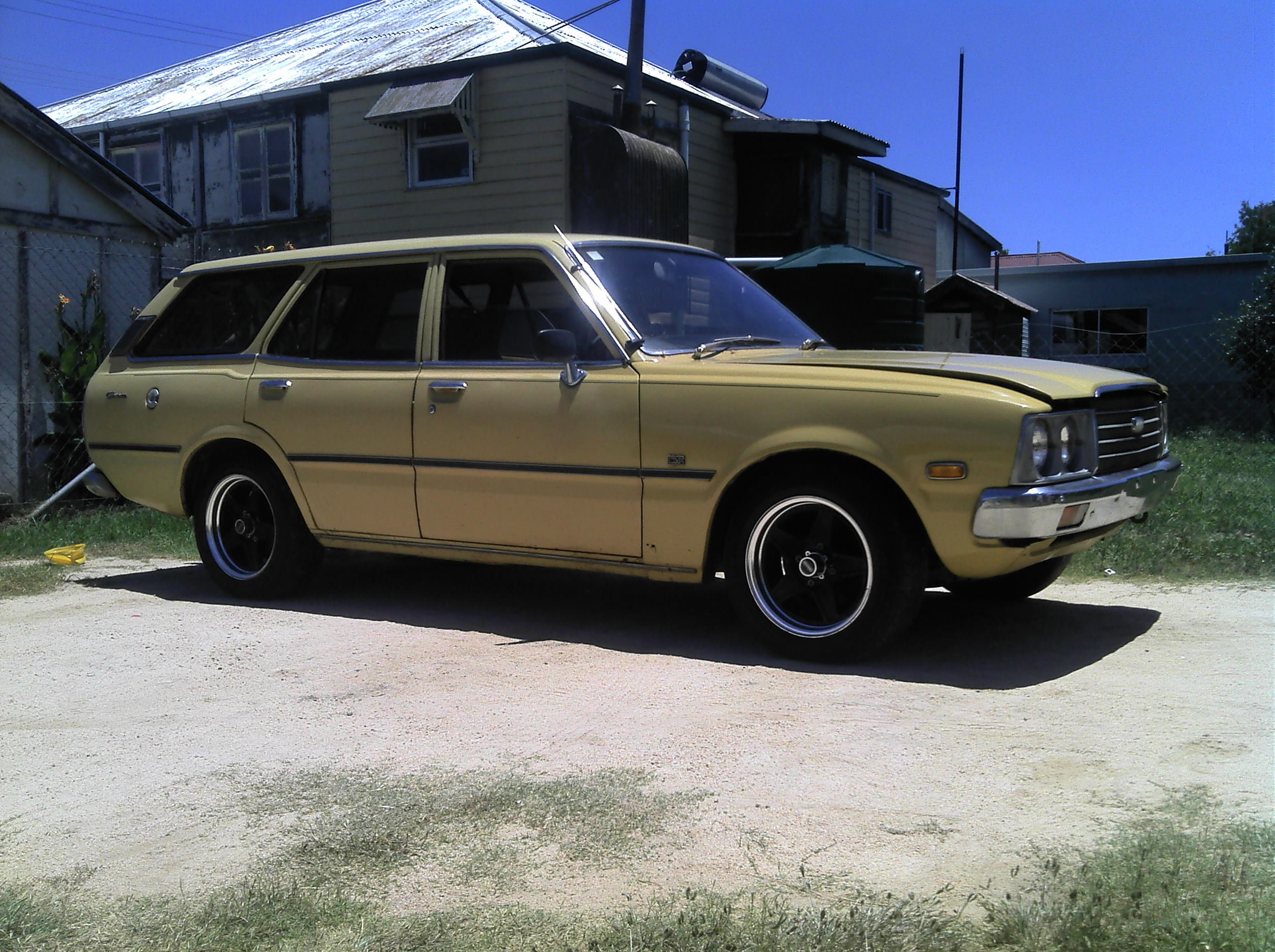

hey liz great to see the old girl coming along so well :) there is no way i would have been able to go as far as you are with her. glad to see she is in good hands, as is my new project ;)
10/4 kemosabe
Wed Feb 08, 2012 2:30 am
nice project! i remember a mate had one back a few years, was a fun car! they look good with some nice wheels and a bit of lowness!
