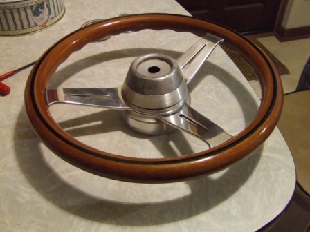

Update on steering wheel and adapter.
A sneak peek on progress so far.
Thu Aug 05, 2010 2:08 am
very sexy! cant wait to see it on bella!

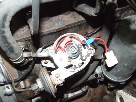

Wiring turned out to be a wire that had pulled loose when I was mucking about with my race tacho.
The carburetor problem was a float set too low.
and of course you've all seen the distributor problem.
Had to sneak up on the tune as one thing needed to be fixed and adjusted to get the next increment on each :(
Hot-spark electronic points conversion is fitted and working (that's what the GT40 coil is for, has to have minimum 1.5 ohms primary resistance).
Engine seems to have lost it's intermittent miss at idle as well !?
