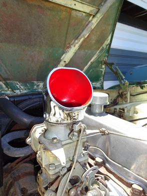

The early Bellett Nikki was bigger. Had bigger jets too.
The late Bellett one was rubbish. Small chokes, small jets.
Is all due to the cam they had.
If u want a Nikki, get a Gemini or Datsun one. You need a different air cleaner tho.
Donkey's is the early Nikki (and doesn't use an air cleaner :twisted: )
