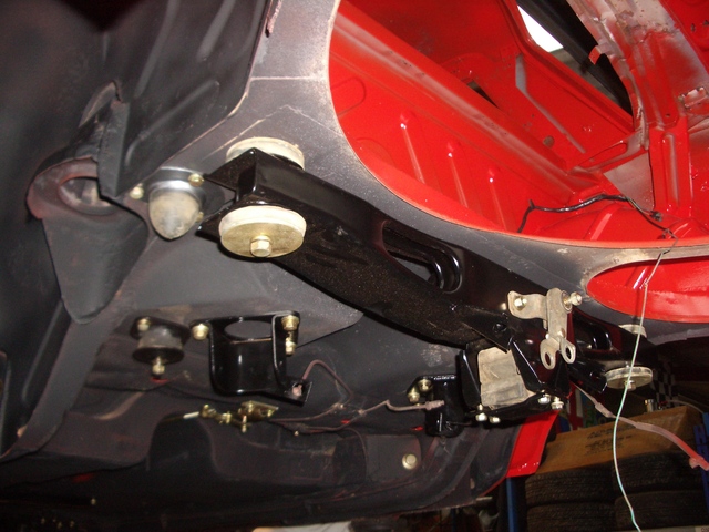

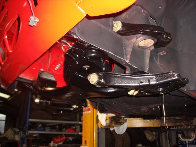

Many thanks guys, it's certainly been quite a ride just getting this far, and it's interesting, as more and more wise old racers drop in at the shop and look at their first ever Bellett, there's more and more talk of Rolie having the potential of being "quite quick". I'm not going to build him up too much, but I'm really looking forward to the first shakedown....and then we'll see.
Meantime the suspension is going in.
Sat Feb 12, 2011 6:55 pm
that does look good, shiny bits on a bellett! are you using new rubbers or the old rubbers in the suspension?
Sat Feb 12, 2011 8:46 pm
Posts: 490
Combination of old and new, some Rolie's bushes looked brand new and didn't need replacing.

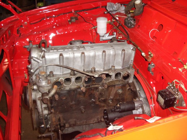

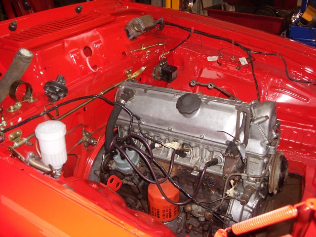

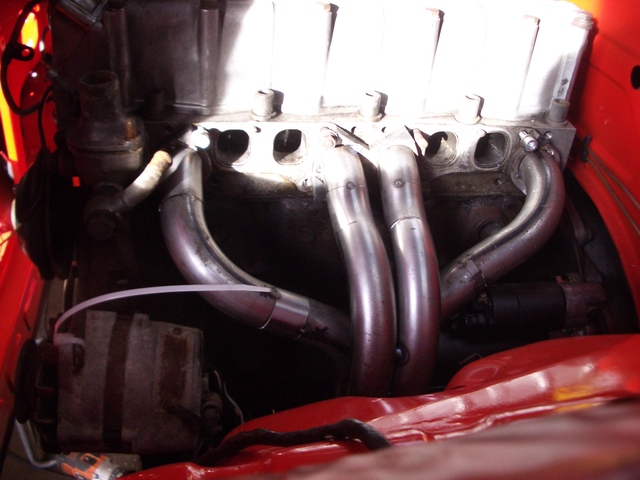

Greetings to all my Belletting mates down under. Update on Rolie is that we've put the unstripped engine in so that we can check that the whole drive train all fits together (which it does,hooray)
and so we can fabricate the exhaust system.

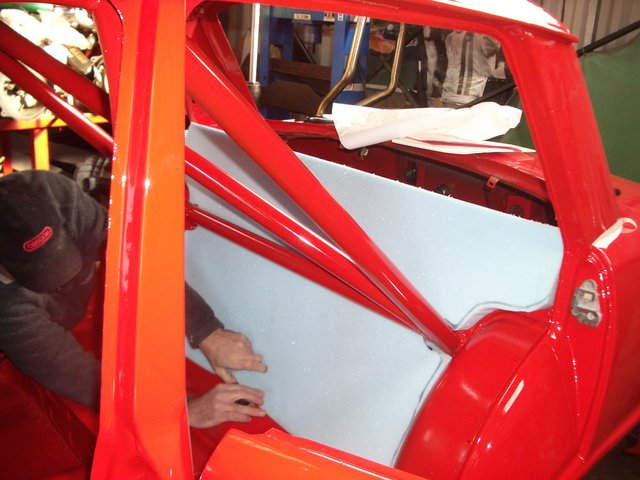

The other picture is us making the fake back seat, we have to run with a rear seat of some kind, and the weight of the original seat and the obvious problem of the roll cage stops us from using it. The foam will be upholstered with the same material that we used for the door cards.

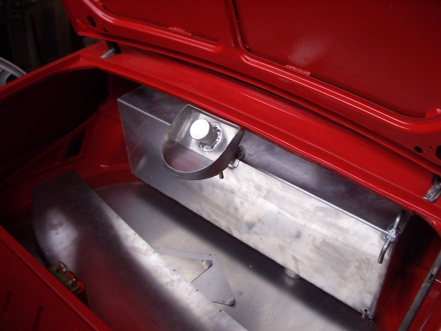

Cheers YP. Hope you're making good progress with yours. Back here in Pomland we got the tank in now..........a little bigger than I imagine, as I'm no fan of enduros, at least a full tank should keep the back end planted :)

Trying to get the exhaust manifold in , quite tricky as it's all a bit snug on that side of the engine.

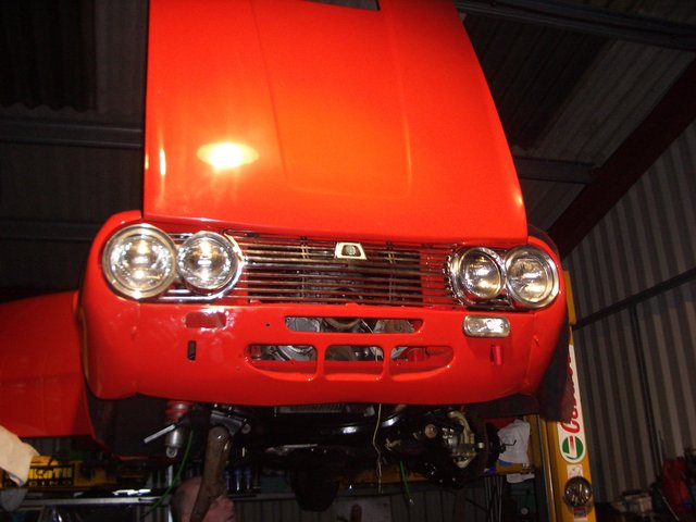

And finally, for a bit of 'bling therapy' we attached Rolie's lights and new grill (the grill came still rapped in a 1965 Japanese newspaper!!)
The 10th of March and our visit to Goodwood and the dreaded eligability police seems very close now, but we're still quietly confident.

Sorry guys, I don't know why my shiney front end came out so small, hopefully this is better..

is that a coil over type shock on the front there? more info? or are the specs secret for now?
Fri Feb 25, 2011 12:03 pm
It looks like an 1800 adapted overhead cam engine from Jap GT and early Chev Luv in the engine bay there, Pom?
Is there twin Dellorto's going on there too..
Sure hope it gets passed ok and you get to give a few other Jap cars a run for their money.
Fri Feb 25, 2011 12:12 pm
Posts: 490
Yes, special recipe coil overs, I'm happy to post the rates and shock spec when we've worked it out ourselves after a few shakedowns.
As for the engine Oz....straight out of a late sixties Bellett Gt, apparently not many of these engines made it to Australia. It's 1600cc.
Fri Feb 25, 2011 12:20 pm
nice choice of grille looks like an early one ...is it black ? its like bembokas cheers davo
