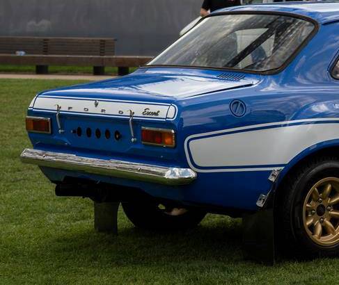

Late model GT tail lights are like hens teeth. Some people use the similar style sedan tail lights if the GT ones are damaged etc. I imagine people hang on to sedan strip lights also, just in case their GT ones get broken. There are not all that many late sedans about either.
Its easy enough to weld up the holes, a suggestion might be to fit something like the early Ford Escort tail lights. Similar shape and pretty flat. Probably easier to find if you don't turn up Bellett ones..

My yellow gt has sedan tail lights in it they would be around Dick was selling new sets for a while. Gt not so easy that's why ol yella is running sedan. The panel was just filled in as it is only slightly rolled flat panel. New holes were cut.
